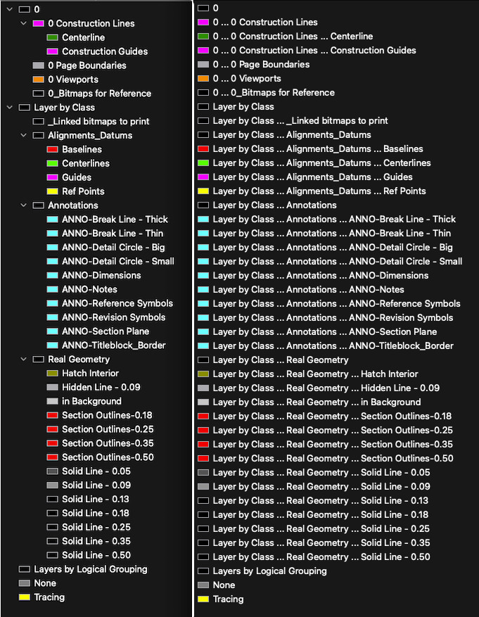

2) Also, layer groups are not present in the layer list, its just a 'flat list'. If I right-click on a layer named "parent" and select "add sublayer" and name the new layer "child", then the newly created layer is named "parentchild" and is on the same level as 'parent' and not nested...so toggling the visibility of 'parent' does not affect 'parentchild', etc. See screenshot below of the exact same DXF file opened in 3.28 (on left) and 3.29 (on right)

Are you sure that you use QCAD Pro?
See menu Help .. About
Hierarchical layers are not supported by QCAD CE.
Are you sure that the use of hierarchical layers is not disabled?
See menu Edit .. Application Preferences .. Widgets .. Layer List
