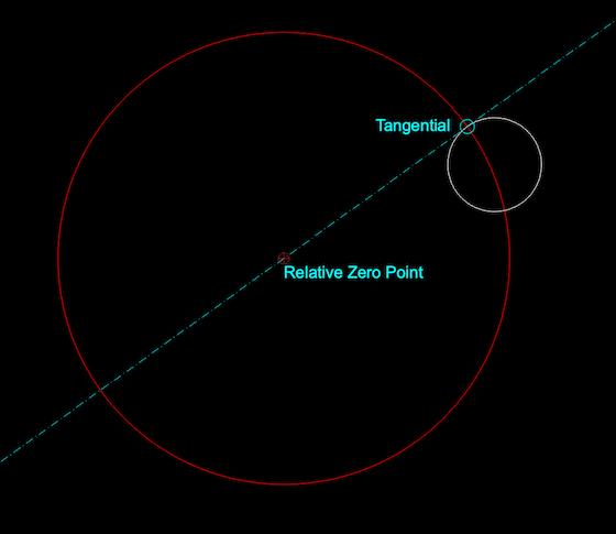

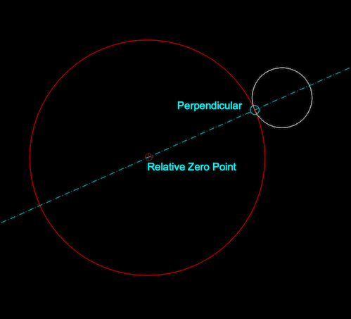

These snap modes snap to the point that is perpendicular / tangential to the line from the last used point (relative zero point) to the entity under the mouse cursor as shown below when constructing the red circle and snapping to the white, small circle.
It's the line between the relative zero point and the entity that is perpendicular / tangential, not the entity that is currently being constructed.
To create a circle that is tangential to another entity, use the specialized circle tools instead.

In perpendicular_snap.png there is a second perpendicular point on the far side of the white Circle.
See feature request FS@2621
Not an issue: There are 2 tangential points for an RZ outside the (full) Circle, no when inside.
