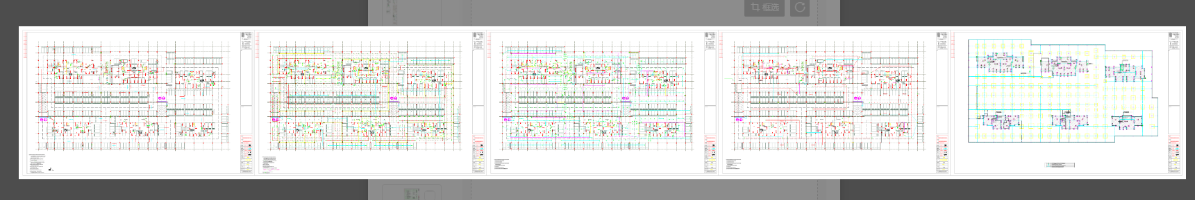

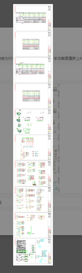

Problem:Whether command line supports identifying and exporting different layers?
Expected output: Export different BMP/PNG files for each layer.
