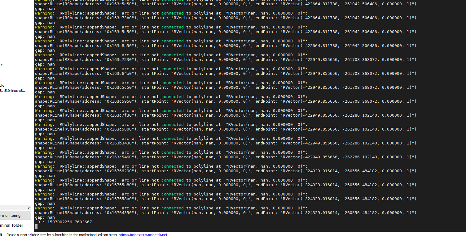

I used the console command ./dwghatcharea -platform offscreen -f 0.001 -s 0.05 C.dwg to calculate block areas, but the execution got stuck and couldn't complete the full calculation.
Issue:./dwghatcharea -platform offscreen -f 0.001 -s 0.05 C.dwg connot complete the full calculation
how can i do it
- Image20250611150611185.png (135.89 KiB) Viewed 15448 times

Re: I used the console command ./dwghatcharea -platform offscreen -f 0.001 -s 0.05 C.dwg to calculate block areas, but t
I suspect invalid content.
RVector(X=nan, Y=nan, Z=0, false) is simply not a valid position.
But also not one of the predefined invalid positions.
Flatten your drawing to 2D to start with.

While constructing the outline ...
We see QCAD attempting to add a line shape (RLine) with an invalid X and Y coordinate value as start.
I saw a glimpse of your drawing before the QCAD GUI crashed on the first screen regenerate.
Perhaps these kind of drawings are just to complex.
