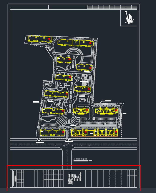

I have another issues: some lines in the DWG file are not rendered when converted to PDF using DWG2PDF. What could be the reason for this?
How can I resolve this issue

- Posts: 4920
Re: The issues with the command line tool dwg2pdf
I didn't intend to give faulty info.
Even this morning there were but 5 hits for the term 'corr' on the Command Line Tools page, 4 pointing to the word 'correction' ...
... Now there are 7 hits meaning that 2 were added meanwhile.
You probably refer to those in the red rectangle ...
... Otherwise please post some handles of the missing lines in the PDF.
In the red rectangle we discover a Block Reference based on Block 'A$C0F44124B'
I can not select that with the cursor, highlighted I can double click it what edits the intended block.
Back in Model_Space the Selection Filter can not select it but TA selects everything.
My block label tool tells me it has handle 0x16db ... TH won't select anything but reports that object 3360 is selected.
We can select all (TA), subtract the mystery Block Reference on referenced Block name with the Selection Filter.
After inverting the selection (TI) no selection remains ...
But it get a bit more weirder ...
Select all by dragging a box with the cursor > 996 entities, in the dropdown it list 7 Block References.
Select all by TA > 1133 entities (+137) > 144 Block References (+137).
TBC
- Posts: 8774
I can confirm that the reference to this anonymous block is not loaded for unknown reasons. I've created a bug report at:
https://www.qcad.org/bugtracker/index.p ... sk_id=2683
- Posts: 4920
The above and probably the missing lines in the export are related to hidden layers.
The content of Block 'A$C0F44124B' are 94 entities on layer 'PUB_TITLE' itself not hidden.
The Block Reference entity '0x16db' lives on layer 'PUB_DIM' what is hidden.
Still, the Block Reference is visible in Model_View and in Print Preview mode.
Also highlighted when pointing near it but NOT selectable with the cursor by clicking or with a box selection, selectable by TA.
I was convinced that the Block entity layers AND the Block Reference layer had to visible so that content was visible ...
If we (re)read all topics filtered on a combination of 'Visible'/'Visibility' and 'Block'/'Blocks' we might get conflicting information.
In the QCAD FAQ (8 aug 2018) is stated that:
The context and several preferences may have an influence:
- Different for Layer 0 in best compatibility mode
- Including the frozen column or not and for the latter case not opting for Off = Frozen
Exporting to PDF using the GUI worked out.
Attempted a life test exporting your DWG to PDF with the command line instruction.
Using a trial of QCAD 3.32.3 was not an option: FS#2684
Reverted to QCAD3.32.1 and I don't see any difference with the GUI export.
The Block in question is rendered fine in PDF although Andrew says otherwise.
For completeness the debug output:
Not all went well I presume but that is drawing file related.
- Turning off the layer of the Block Reference will make the whole block reference invisible.
- If a layer is off, block references are still shown but these are not shown when the layer is frozen.
- If an entity is part of a block, the entity also becomes invisible if the layer the block reference is on is hidden.
- When turning off the block content layer, the block reference on another layer is not hidden.

I tested it on a Win7 machine with QCAD 3.32.1 (point 2 failed) typically Qt 5.13.2, perhaps OS or Qt related.
There are other problems with the drawing file, see debug output.
No, probably not, otherwise FS#2683 would have the fixed status.
It is assigned to Andrew but that is automatically.
