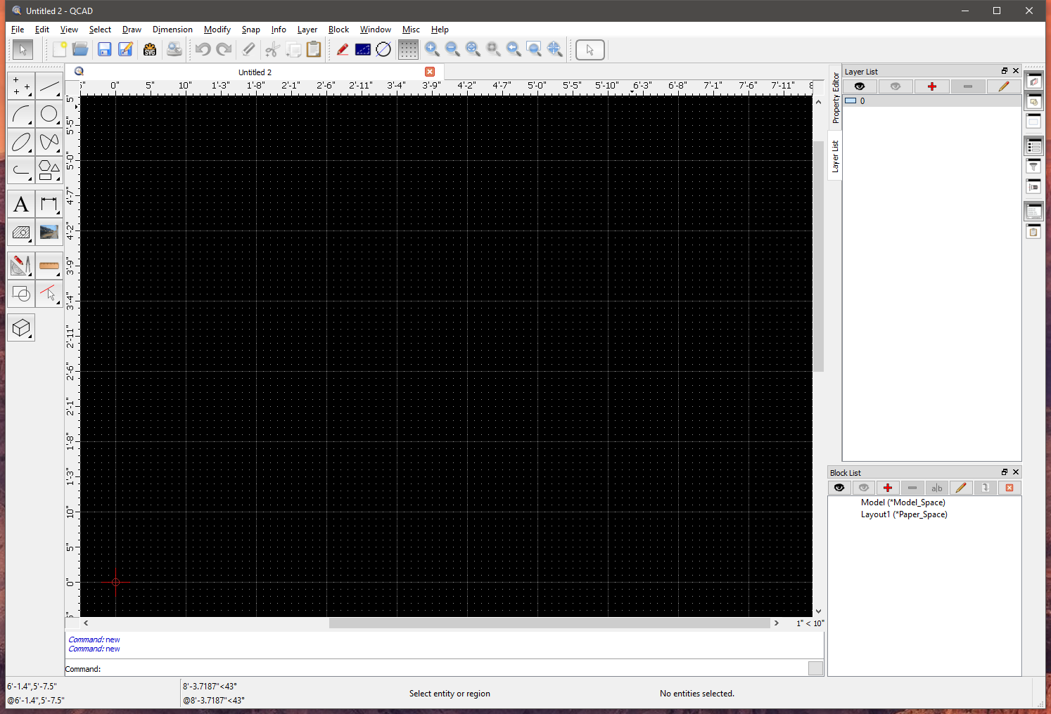

Hey, my layer list just isn't working properly. There is supposed to be an eyeball and a lock icon on each layer. Its missing on my PC. Strangely enough, if I click around on the empty space, I can change the layer visibility if I click on the right spot. So it's almost as if the icons are present, but not being rendered.
Please help.

Unfortunately, I cannot reproduce the problem here and we didn't have any similar reports so far.
Can you please try to re-install QCAD Professional?

I have uninstalled and reinstalled QCAD and I'm STILL having this problem. This makes it very hard to use. Please let me know how to fix this.

I've done all that and more, including uninstalling other QT programs on my system. The icons remain forever hidden.

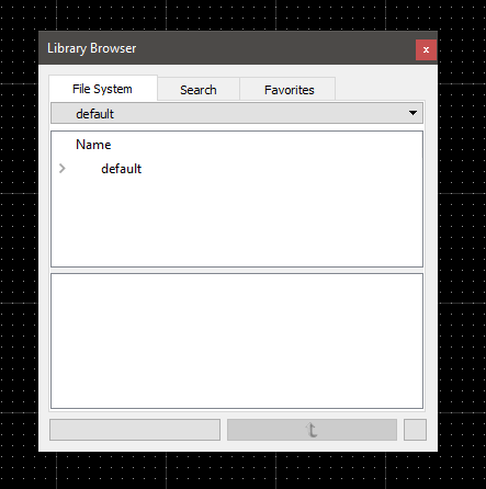

This is not a problem unique to my particular PC, this is a problem with the way QCAD uses QT, specifically qtsvg.andrew wrote: If the above does not work, I'm afraid this would be a problem unique to your particular installation of Windows / QCAD. Please contact me for a refund.
I have the same problem in both layer list and block list, and behold my Library Browser: I'm looking at the source now. My best guess is that one of the many other open source programs I have installed have used a version of QT that is interfering with the SVG rendering.
