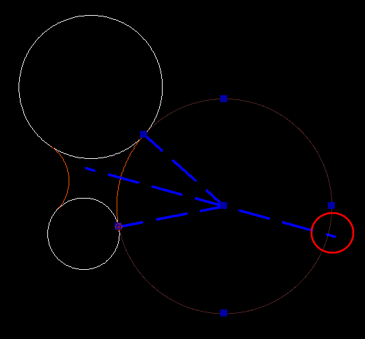

Using your actual draft, for now if you pick a point more or less opposite the arc you wish to keep it should break out the rest.
Before...picking an opposite point.
Break out 1.png (4.99 KiB) Viewed 5346 times

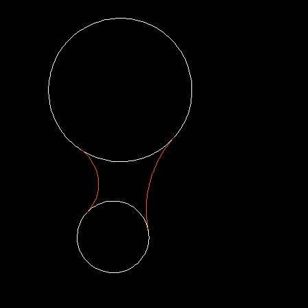

After.
Break out 2.png (1.95 KiB) Viewed 5348 times
