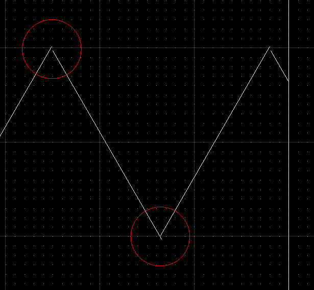

A most simple pattern.
Good numbers maxed out in digits would be: e_geek
0.577350269189626
1.15470053837925
What gives: (and fit 80 chars)
60,0,0,0.577350269189626,-1,1.15470053837925,-1.15470053837925
120,0,0,0.577350269189626,1,1.15470053837925,-1.15470053837925
I do not favor negative dY (-1) and suspect problems with it. :?
Properly addressing the 1e right hand clone with dX & dY gives:
60,0,0,1.73205080756888,1,1.15470053837925,-1.15470053837925

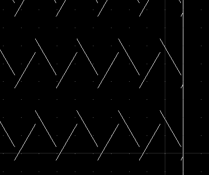

Question it if you like.
The AUTOCADhatch.com version @ a span of 500.
Lean HPZG60N1.pat @500
Lean HPZG60N1.pat @10000
One thing is sure: They don't hurt.
