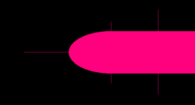

As extra information:
An arc as boundary must be scaled non-uniform to an ellipse-arc, a circle as an ellipse.
With a difference in Block Reference scale factors more pronounced then 1.016667 vs 1.22 it is better visible that it is rendered as such.
Also meaning that the top slots all have semi full ellipses with an axis ratio of 0.83333... and not scaled semi-circles as probably intended.
@ 2CV375: I would at least include boundary shapes, certainly when the intention is to explode everything in a final stage.
Why it is perfectly rendered but not exploded as it is rendered remains a mystery to me.
