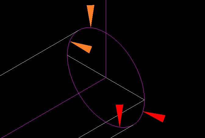

Greetings!
I installed the latest edition (3.32.3.0 (3.32.3)) (Windows 11pro) and now the Breakout line segment is not working properly. In the below example I am trying to draw a cutaway of a part using isometric projections. In the example I am trying to trim the purple circles, but they ether don't trim at all, trim a section I didn't click, or removes the circle entirely. I have literally drawn hundreds of parts using this method using previous editions and now its not working. Any ideas on what is going on?

Please check the options toolbar at the top while using the tool. Make sure that "Remove Segment" is checked and "Line Selection Mode" is not checked.

Hi Andrew, I looked and "remove Segment" is checked and "Line Selection Mode" is not checked. Tried it again and still having the same problem.

I can replicate the weird functionality with trimming parts of the magenta Ellipse entities at the right.
Probably related to updates to the ellipse resources since QCAD 3.32.0.
Some were moved to the Pro or proprietary realm but it can be some QSharedPointer issues too.
Unable to verify what goes wrong because a least some parts are proprietary code now.

Divide (DI) each full Ellipse entity up in 2 Ellipse-arc entities.
It may be required that intersecting lines are really crossing, elongate them a bit.
If you attempt DI at the intersections with the blue line under QCAD 3.32.3 it is cut up at the minor points.
Proving how wrong it can be. :roll:
getVectorTo(p) where p is one of the intersection with the blue line returned a minor point as cutting position. :wink:

Update:
Probably boils down to Ellipse - Line intersections failing in the latest releases.
Filed a bug report with an example file: FS#2685

Traced back to RShape.getIntersectionPointsLE(line1, ellipse2, limited); (Where suffix 1-2 are swapped)
Line 771-776 verifies if the line is (almost) a tangent. (current reference)
  • ellipse2.getTangentPoint(line1); returns the ellipse center.
    Which is a valid RVector and is therefore wrongly considered the only solution.
    Not quite the center of the ellipse, the returned point is 3.972e-15 away from it what falls within RS.PointTolerance.
I then verified why getTangentPoint comes to that conclusion ...
:arrow: ... Because the blue line is not a tangent at all, it clearly crosses the ellipse twice.

Chuckk, Andrew,
Using the latest release (3.23.4), D2 still has problems with breaking out some obvious ellipse segments in your example file.
Found intersections of lines and the ellipse, and thus breaking points, are already much better. :wink:
D2 and indicating near segments with the red arrows removes the ellipse shape completely.
Undo (OO) reverts back to the original.
D2 failing QCAD 3_32_4.png (7.12 KiB) Viewed 43647 times
This is probably unrelated to intersections with an ellipse because we can snap to all 8-9 obvious intersections points for this case.
At the high side it is suspected to be a case of a tangent line but then not actually crossing, nearly but just outside the ellipse.
No snapping to an intersection occurs for the two tangent lines.
D2 failing QCAD 3_32_4 high.png (6.31 KiB) Viewed 43647 times
For the segments indicated with orange this can be fixed with trimming the line to the ellipse (RM).
But trimming (RM) the tangent for red results again in removing the ellipse shape completely with D2.
Evaluating this setup mathematically in terms of the backing code may shed some light when and why this happens.
To my knowledge, nearly a tangent to an ellipse but just outside is still not accounted for.
A true tangent, or nearly but crossing twice extremely close together should not be a problem.
For the latter, the code returns only one of the two positions, arbitrarily, not something in between.
