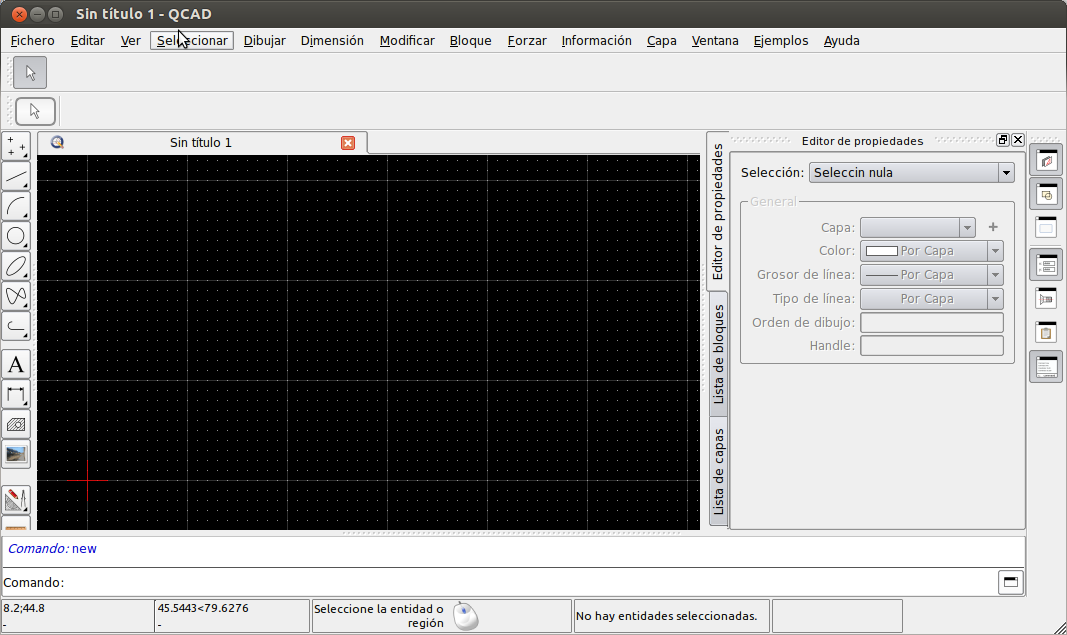

- Posts: 16
- Joined: Wed Oct 15, 2008 12:38 pm
Re: Qcad3 profesional open with "plastique" and I want clear
Hi Andrew,
With your code didn't work, but it works adding gtk in the option 2. See capture 1: don't work, and capture 2: OK.
Thanks
Thanks
- 2: OK.
- 2.png (86.92 KiB) Viewed 18383 times
- 1: don't work
- 1.png (88.71 KiB) Viewed 18383 times
