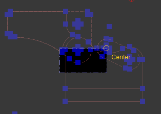

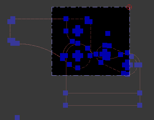

I'm trying right now to use the "Clip to rectangle / clip to area tool.
Unexpected I have problems to define the size of an area - but not in all parts of the drawing and I don't know why!
"Big area" = impossible - the left mouse click is not accepted
"Small area" ... works. Why??????????
