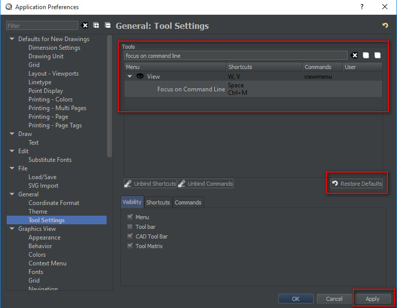

Hi renod
Have you tried ?
Main menu > Edit > Application Preferences > Tool Settings - type and search 'Focus on command line' restore the default settings and click apply.
view focus on command line.jpg (86.87 KiB) Viewed 21210 times
Let us know if this does the trick or not.
Re: Space doens't focus on command line (Linux mate)
Posted: Thu Jul 28, 2016 11:21 pm
by renod
Thanks Clive :)
I did restore the settings but without expected results.
Even CTRL-M doens't work.
But others shortcuts like CTRL-N works...
