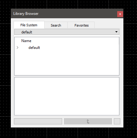

I have the same problem in both layer list and block list, and behold my Library Browser:
I'm looking at the source now. My best guess is that one of the many other open source programs I have installed have used a version of QT that is interfering with the SVG rendering.

QT_PLUGIN_DEBUG didn't produce any output.
However I finally found the program that was interfering with QT. It was OpenShot. It set QT_PLUGIN_PATH in the environment.
I was going to recommend that QCAD always open plug-ins from it's own install, however according to the QT5 documentation:
Note: QT_PLUGIN_PATH should not be exported as a system-wide environment variable since it can interfere with other Qt installations.
Therefore I will consider it a bug in OpenShot and report it with them.
