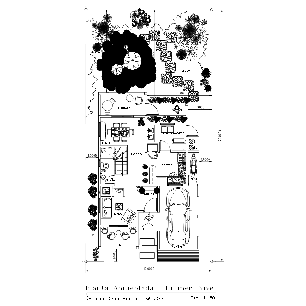

Posting here because I just noticed that dwg2bmp is rendering points on the drawing as very thick circles:
Notice the two black circles where it says "RECIBIDOR" and all the black spot on the tree block.
I believe all the points in the file have min line weights set by a previous script, not sure if this is a problem with the point properties in the file, or something that dwg2bmp is skipping...
Posting the original dwg file as attachment.
Converting the file like this:
dwg2bmp.bat -background=white -width=1024 -height=1024 -force -antialiasing -monochrome -color-correction -zoom-all -no-weight-margin -o .\test_file_points_clean.png .\test_file_points_clean.dwg

Thanks for your report. Bug report at:
https://qcad.org/bugtracker/index.php?d ... sk_id=1894
The problem is related to PDSIZE being set to 0 which means "5% of drawing area height".
