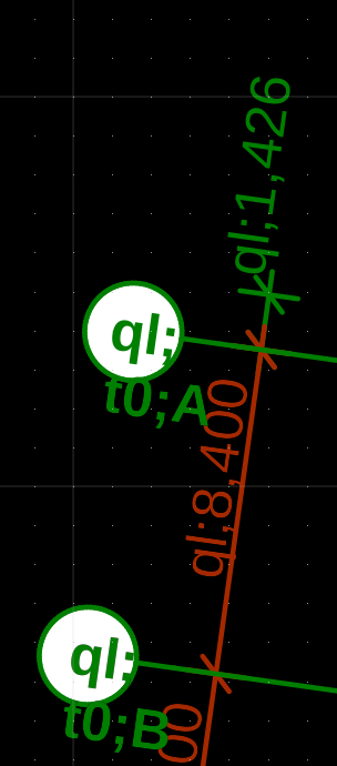

I imported a DXF using the professional version qcad-3.27.6-pro-linux-x86_64 and all text strings have codes prefixed to them like "ql;". When opening in QCAD qcad-3.25.2-trial-linux-x86_64 the text loads correctly though. Perhaps this is a regression? Anything I can do to help?

Here is a file with a single circle and single text number "1" which currently appears as "ql;t0;1".

Yes, it is reproducible. Other program and prior QCAD versions have no problem with that text. Please file a bug report below www.qcad.org/bugtracker.
