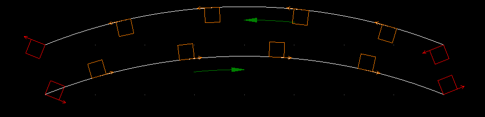

When indicating an entity to paste on with PE it only seems it always start at the start point of that entity.
Sun Oct 30, 2022 8:08 am
The tool always starts at the beginning of the base entity.
Is thus a faulty determination that was based on the used angles.
The tool is intended to start at the indicated side what can be tested with a distance not fitting the full base, excluding endings.
On this condition for the indicated point and the nearby shape:
if (this.pos.getDistanceTo(this.shape.getEndPoint()) < this.pos.getDistanceTo(this.shape.getStartPoint()))
It detirmines to start at the begin or at the end of the entity.
Variable from is then RS.FromStart or RS.FromEnd, and notFrom is the inversed.
The endings their associated local angles are:
- Angle at start ... this.shape.getAngleAt(0.0, from|RS.AlongPolyline)
- Angle at end ... this.shape.getAngleAt(0.0, notFrom|RS.AlongPolyline)
What means that the angle values are swapped depending the indicated side.
But as start point it always includes: this.shape.getStartPoint().
And as endpoint: this.shape.getEndPoint().
Meaning that these are :!: not swapped :!:
This issue can be best visualized on an arc segment with option 'Align' and option 'Include end points' indicating beyond halfway the base entity.
