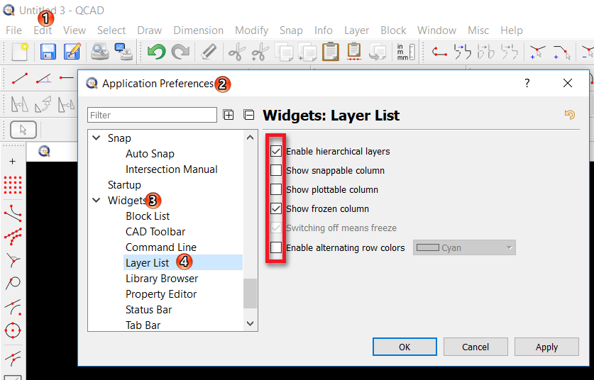

Maybe that explains our "misunderstanding".matita wrote:The youtube video shows 5 columns, something I have never seen.
Below Application Preferences is the possibility given to make those columns visible/invisible. I work with 3.19.2.

Re: toggle visibility of groups of layers - feature cancelled
Thanks! That crept in somewhere between the versions I have. As you say, it solves my immediate problem. I would mark the heading 'solved' if I could edit it
