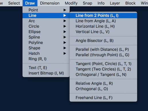

- If you prefer to browse tools through a text interface, you can use the standard menu at the top, as in most applications (e.g. Draw > Line > Line from 2 Points).
Screen Shot 2017-06-23 at 09.19.05.png (138.11 KiB) Viewed 81604 times
