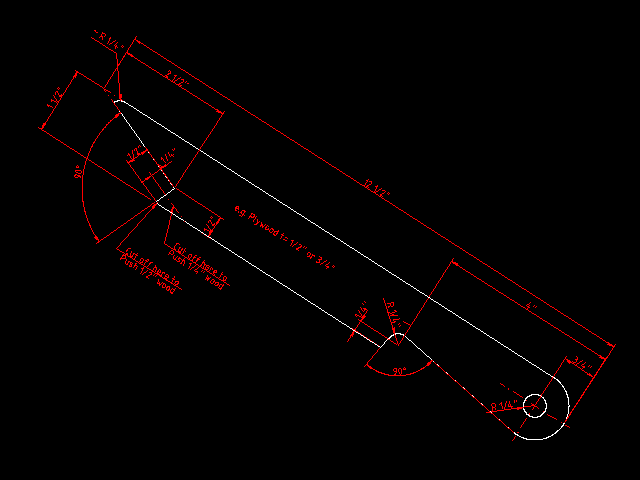

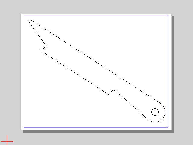

I was in need of a simple Table Saw Push Stick .... maybe you too :wink:
Free to use for all QCad User!!!
Husky_Table Saw Push Stick Print View.png (4.48 KiB) Viewed 75164 times
Husky_Table Saw Push Stick QCad Design.png (9.83 KiB) Viewed 75164 times

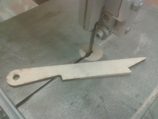

Thanks for this, I re-scaled your little push stick, changed everything to a continuous polyline and changed the line-weight to 0.00mm and cut out on the laser cutter.
Now its perfect for using with the little bandsaw for small jobs, I`m sure it will be the first of many!
See below - photo`s of the ' Husky' push stick MK 1 :wink:

Re: Table Saw Push Stick ...
Post by Husky » Mon Oct 22, 2012 10:27 pm
Nice!!! Thanks for the feedback! I like to see "Finger saver" around the world :lol:
