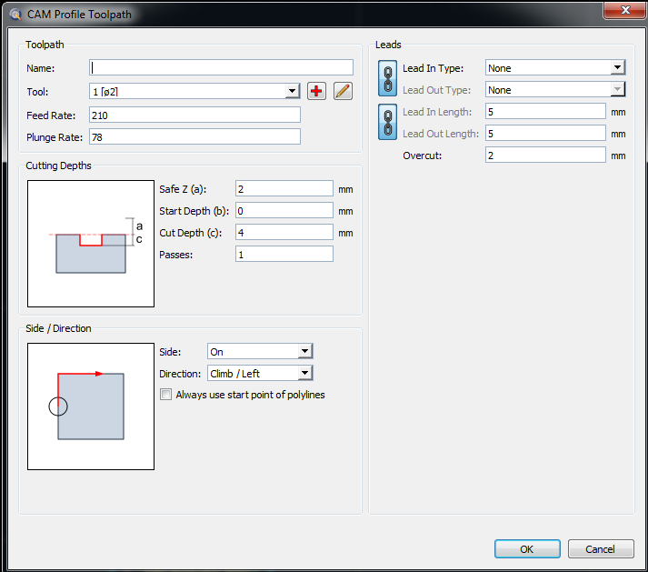

how can i set the preferences in the Cam Profile Toolpath Menu?
thanks

I want to set i.e. the cutting depth or the side/direction parameters to my requirements when open the Menu. I almost need 2mm cutting depth, preferece is 4mm.
thanks

You can override initDialog in your post processor and change the default values, for example:
GCodeOffsetMM.prototype.initDialog = function(dialog, di, resourceBlock) {
    // adjust profile toolpath dialog:
    if (dialog.objectName==="CamProfileToolpathDialog") {
        // change default cutting depth:
        var leCuttingDepth = dialog.findChild("CamZCuttingDepth");
        leCuttingDepth.setValue(20);
        // change default side:
        var cbSide = dialog.findChild("CamSide");
        cbSide.currentIndex = 0; // 0: none, 1: outside, 2: inside
        // change default direction:
        var cbDirection = dialog.findChild("CamDirection");
        cbDirection.currentIndex = 0; // 0: Left, 1: Right
You can find more control widget names in the attached user interface definition file (XML).
