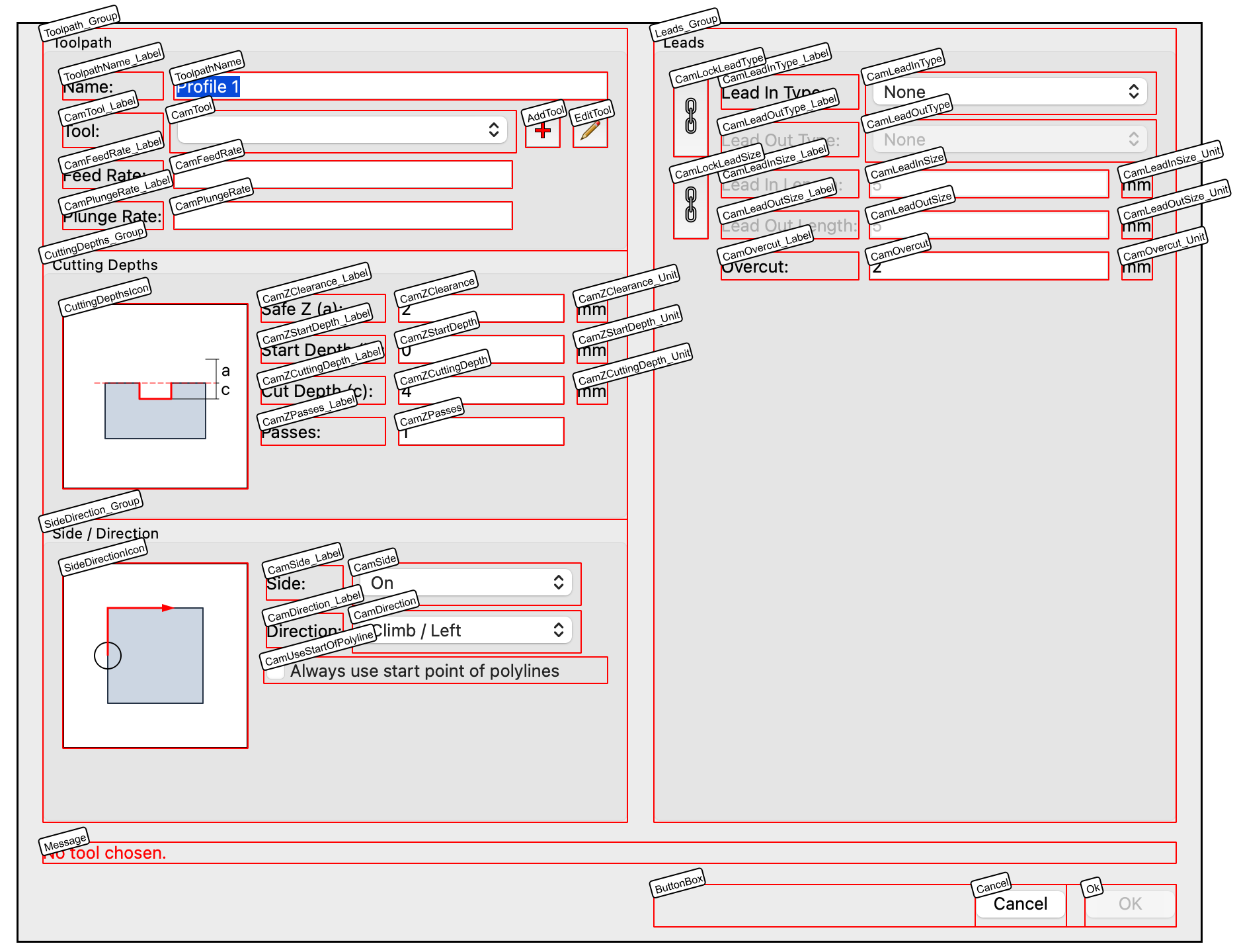

The widget names of the profile toolpath dialog are:
And for the CAM config dialog:

Perfect, thanks for the diagrams!!
