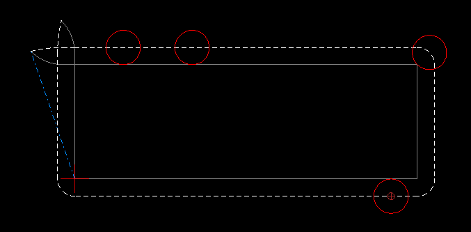

Can anyone please explain the start and end cutter trajectory paths? The 'donkey ears'.
Example of basic offset post GCodeOffsetMM.
  • Blueish is a traverse at Zsave.
  • Dashed is the cutter trajectory at Zcut.
  • Continuously is the contoured edge at Zcut.
The arcs in continuous Linetype are the intended Lead In/Out: An eighth circle with radius 8 ...
... I already have a problem with why this can't be with a radius less than the cutter diameter but whatever. :?
Donkey ears 1.png (2.83 KiB) Viewed 60562 times

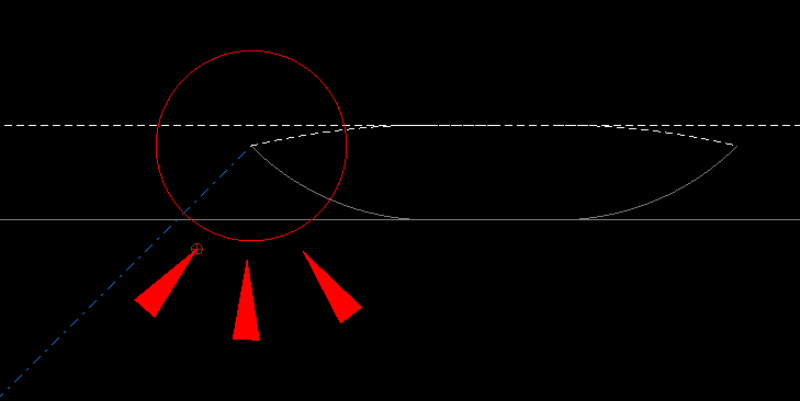

If we add representations of the cutter with R6 at various places then the milled contour itself is fine:
Donkey ears 2.png (3.35 KiB) Viewed 60562 times

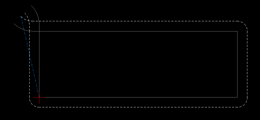

But if we look at that in detail for the start and end of the trajectory then things don't add up.
Donkey ears 3.png (7.38 KiB) Viewed 60562 times

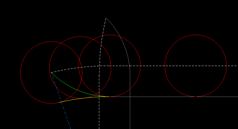

Instead of the intended cutter entry (green) I get a different arc entry shape (yellow) with a diameter of 21.68695112.
Then I figured that this is merely a representation where the cutter trajectory is somehow linked ... Connected to the edge being cut.
But looking at the G-Code it is exactly the dashed trajectory that is exported.
... G0 X-7.6569 Y22.3431 ... End of traverse at Zsave
... G1 Z-4 F150 ... Plunge to cutting depth
... G2 X-2 Y23 I5.6569 J-24.0301 F1000 ... Arc to (-2, 23) with radius sqrt(5.6569^2 + 24.0301^2) - R3 = 21.68696465
So, instead of a convex attack motion for 45° with R8 the real motion of the mill edge is concave for just over 13°with about 2.7 times the radius.

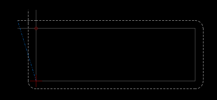

Agreed, this is a corner case ... Let's force the start position to elsewhere:
It should be clear that the cutter ruins the face to mill on entry and exit :!:
Donkey ears 4.png (4.02 KiB) Viewed 60562 times
IMHO connecting the cutter trajectory and edge being cut is wrong ... A mill cannot change in diameter unless it is conical.
