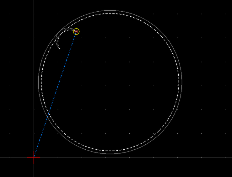

How about something like this? The drilling happens at the start of the lead in, the drill toolpath is based on a point entity constructed there.

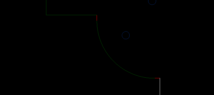

First have a look at the new outer contour.
Where the quarter circles where typical 90 degrees they are now about 95 degrees or nearly 100 degrees.
You probably have trimmed them to the larger straight edges disregarding the short edges at those corners.
At the left high quarter circle the 2 slots are disregarded.
These 2.5mm wide slots can not be cut by the newly added profile with a 6mm cutter.
And hardly by the 2.5mm toolpath in the former art because a round cutter can not cut a sharp inside corner.
The minimal interior rounding radii are half the cutter size.

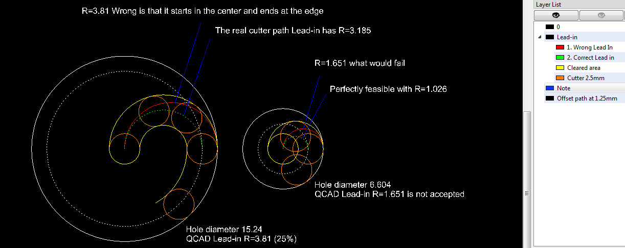

Partial solution:
The only way I see that a Lead-in path can start at the center of the hole and end cutting tangentially at the outer edge is using a hole size related Lead-in that is a semi circle.
Under QCAD/CAM and for a hole of 15.24mm diameter that would be something as a semi circular Lead-in with R=3.81 (=25%
But for a hole of 6.604mm that would fail
... Simply because R=1.651mm and for some reason the entry radius must be larger than the tool (>2.5mm).
Below you can see that it is perfectly feasible and that the radius of the entry path is not 1.651, in green with R=1.026 it is even smaller.
In yellow I represented the cleared area by the cutter and that is fully unrelated to the red Lead-in.
But perfectly related to the green entry path.
For me this is a misconception

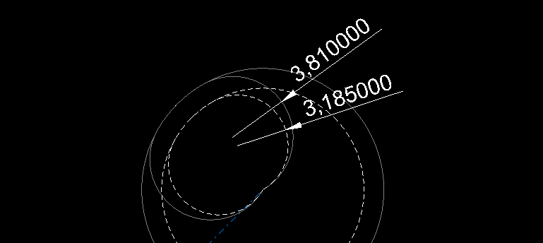

There is something wrong with calculated offset paths ...

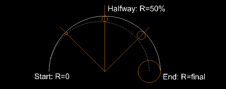

Seemingly the circular Lead-in is defined as the arc from center mill to the outer edge of the mill (In red).
As if the cutter has no size to start with and ends with a certain radius.
As if the cutter size is gradually compensated from zero to R=2.5mm.
Mimicking G41/42 but a (linear) cutter compensation can never be done in a circular motion.
The motion required going trough the virtual centers is not a simple arc and certainly not supported by all motion controllers that I know of.
Related: https://www.qcad.org/rsforum/viewtopic. ... 724#p44206
For a eighth circle I call it 'donkey ears' and you may discover that it won't be fixed.
You fooled the profile generation with a cutter = 2.499 and Lead-in Radius = 2.500
But that won't do the trick ....
And it is not the whole story because we are missing the cutter path starting at the Lead-in begin and something similar for the Lead-out.
The standard assumptions and Math for the offset are failing here.
The offset path should be a dot, simply plunge and back up with no motions in XY and disregarding a Lead-in/out or overcut.

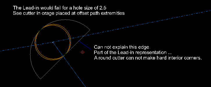

A hole that is pre-drilled by a 2,5mm drill ... Does that require milling by a 2,5mm mill?
As said, the QCAD/CAM Lead-in radius must be tweaked according the hole size.
There is no one shoe that fits all.
Applicable for hole sizes of over twice the Lead-in radius although it is feasible for 100,00..01%

I understand the simplicity of your approach Although it is a manual intervention.
May I still point out that the outer contour of test27-6-2024.dxf can not be compared with the initial design in the Test.dxf
The larger circular contours where 90° and ended in line entities indicated in red:
The two slots left high are not fully milled 'open' because the contour is not open at that point.
I have my reserves over plunging into a pre-drilled hole of the same diameter ...
I see no reason to mill out a pre-drilled hole of the same diameter ...
