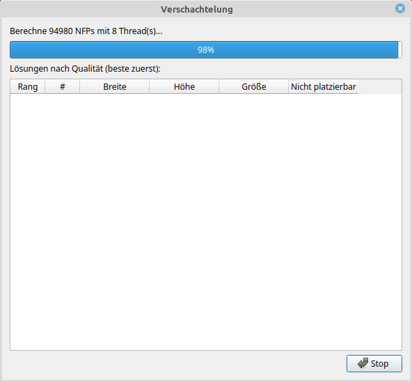

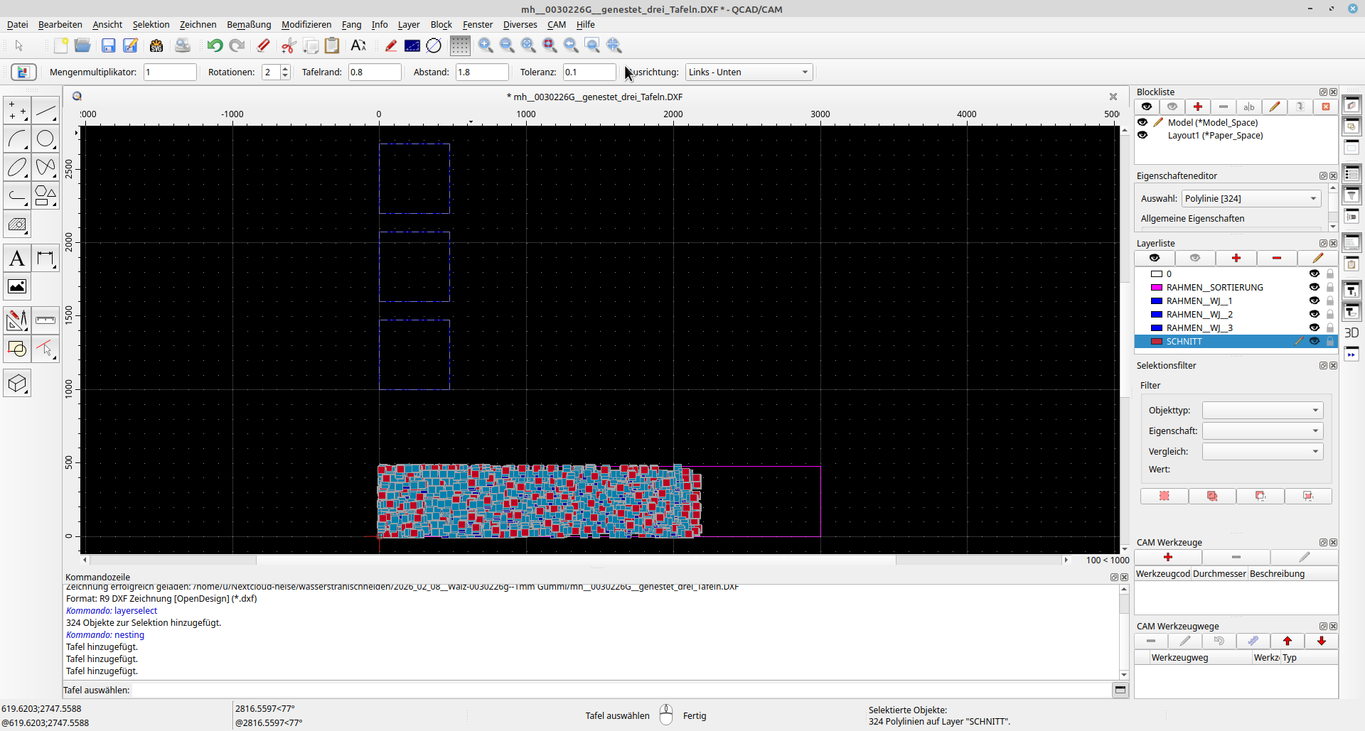

- screenshot__2__preparing_to_nest.png (228.5 KiB) Viewed 251 times
- screenshot__3__first_calculation_of_NFPs.png (20 KiB) Viewed 251 times
- Here my problem, can be seen in the wrong sorting of result
- screenshot__4__first_result_is_not_optimal.png (70.25 KiB) Viewed 251 times
- And more wrong results shown first in the list
- screenshot__5__more_not_optimal_results.png (70.17 KiB) Viewed 251 times

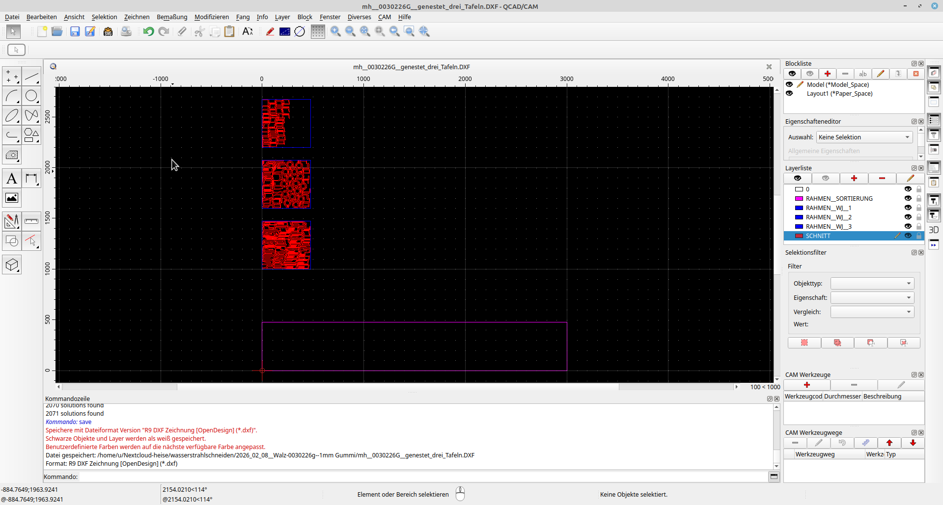

- screenshot__6__after_nesting.png (220.36 KiB) Viewed 251 times
- mh__0030226G__genestet_drei_Tafeln.DXF
- This is after the nesting
