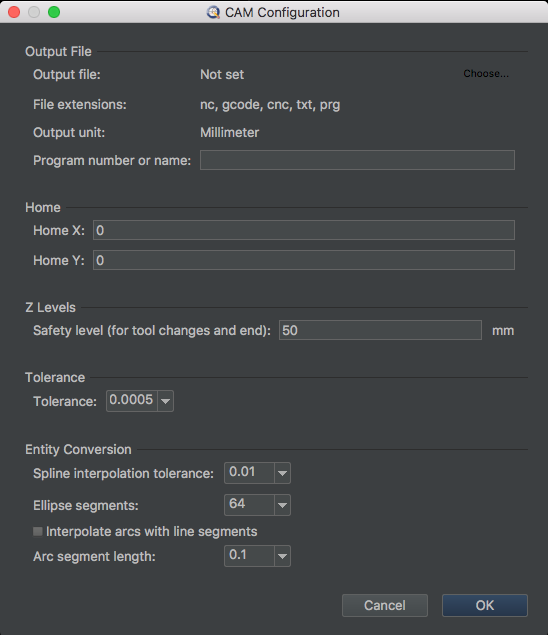

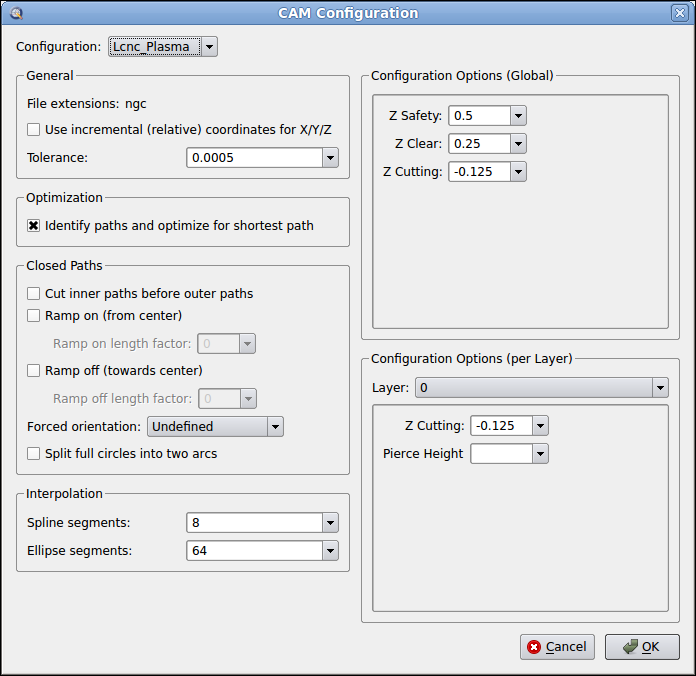

Why it is my Configuration Options missing "per Layer" options? Just compared my Configuration Options dialog box with the one posted in the first page of this thread and they looks quite different. It is there a manual or something where it is explained how to configure all this things?
- Posts: 8785
Re: Adding Options to the CAM Configuration Page
The first dialog posted is from QCAD/CAM 3.17 or later which is toolpath based (1. create toolpaths from entity selection and assign various CAM related properties, 2. export said toolpaths through a post processor to G-Code etc.).Dacicusan wrote:Why it is my Configuration Options missing "per Layer" options?
The second dialog is from QCAD/CAM 3.16 or earlier (legacy) which can only export the whole geometry in a drawing in one go with identical parameters or to a certain degree use parameters on a layer basis. This legacy export is still available in QCAD/CAM >= 3.17 under CAM > CAM Legacy Export.
The brief QCAD/CAM Tutorial should get you started on QCAD/CAM 3.17 or later:
https://www.qcad.org/doc/qcadcam/QCADCA ... ial_en.pdf
More documentation on QCAD/CAM and creating toolpaths will be made available once the interface stabilizes. QCAD/CAM 3.17/3.18 is still new and might still be undergoing substantial changes in the coming months before stabilizing.
