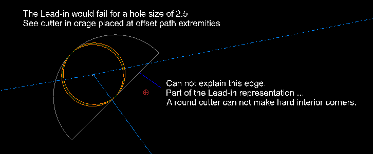

Partial solution:
The only way I see that a Lead-in path can start at the center of the hole and end cutting tangentially at the outer edge is using a hole size related Lead-in that is a semi circle.
Under QCAD/CAM and for a hole of 15.24mm diameter that would be something as a semi circular Lead-in with R=3.81 (=25% :wink:)
But for a hole of 6.604mm that would fail :shock: ...
... Simply because R=1.651mm and for some reason the entry radius must be larger than the tool (>2.5mm).

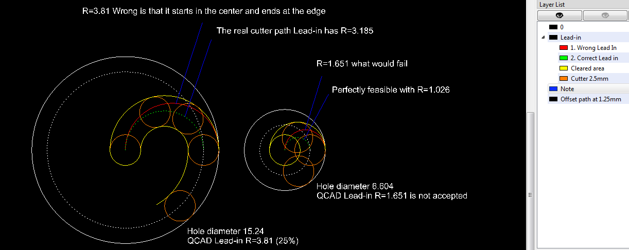

Below you can see that it is perfectly feasible and that the radius of the entry path is not 1.651, in green with R=1.026 it is even smaller. e_geek
In yellow I represented the cleared area by the cutter and that is fully unrelated to the red Lead-in.
But perfectly related to the green entry path.
Also see attached dxf
Lead-in from center.png (28.51 KiB) Viewed 74308 times
Lead-in from center.dxf
(102.96 KiB) Downloaded 853 times

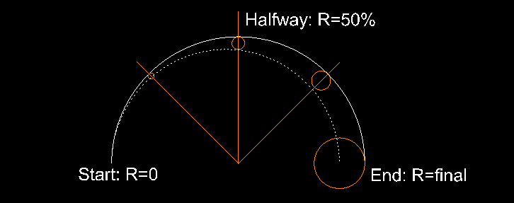

For me this is a misconception :!:
There is something wrong with calculated offset paths ...
Seemingly the circular Lead-in is defined as the arc from center mill to the outer edge of the mill (In red).
As if the cutter has no size to start with and ends with a certain radius.
As if the cutter size is gradually compensated from zero to R=2.5mm.
Mimicking G41/42 but a (linear) cutter compensation can never be done in a circular motion.
The motion required going trough the virtual centers is not a simple arc and certainly not supported by all motion controllers that I know of.
Practically impossible
Circular cutter compensation.png (5.9 KiB) Viewed 74308 times

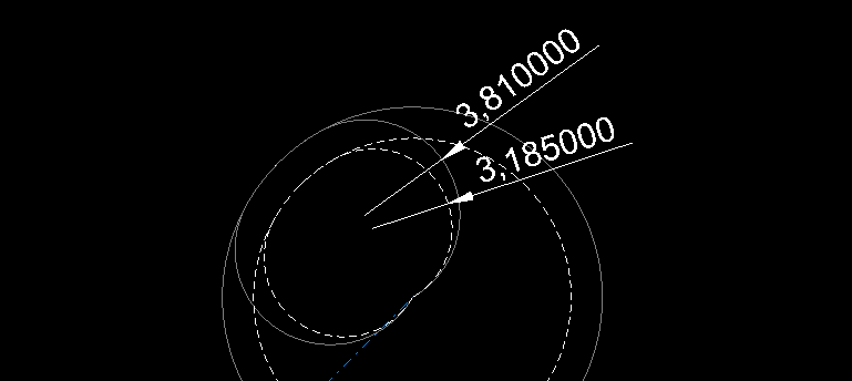

For a 15.24mm hole, 6.604mm not feasible
Lead-in from center QCAD.png (7.17 KiB) Viewed 74185 times
