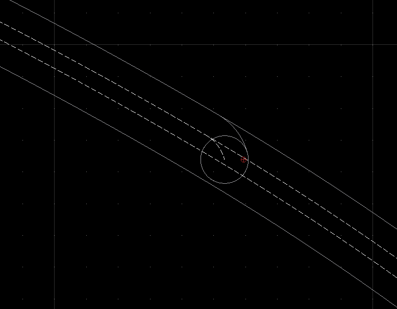

So I tried some "Laser" post-procesosrs with the "laser" tool (with 1.5mm in diameter) and set the entry to eighth of circle with a radius of 5mm. It does look like it works at first but the 5mm radius is applied to the "normal" path and the offset path starts directly from that point. In some configurations, depending on the curvature of the path, it results in getting the peircing point between the normal path and the offset: it will be seen in the final part...
bad peircing with laser tool.PNG (8.55 KiB) Viewed 74933 times
I can understand that the radius be applied to the normal path and not to the offset path, but the tool still has a diameter (thus a radius) which is not taken into account... And I think the laser tool was thought with a 0mm diameter and more for engraving or cutting paper thant cutting steel :wink:

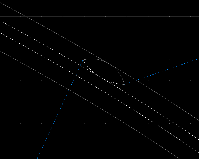

What would be correct for plasma (and laser) is that both arcs ("normal" and "offset" have the same center). I hand made this:
good peircing with new plasma tool.PNG (11.94 KiB) Viewed 74933 times
The circle would represent the minimum peirced hole (could even be bigger to be realistic)
A variable length or angle would also be preferable to only half/quarter and eighth...

The only difference with a mill or a drill is that a laser is not a rotational cutting tool.
The naming and the purpose of the tool doesn't matter at all.
Simply set a certain small spot diameter for proper offsetting. :wink:

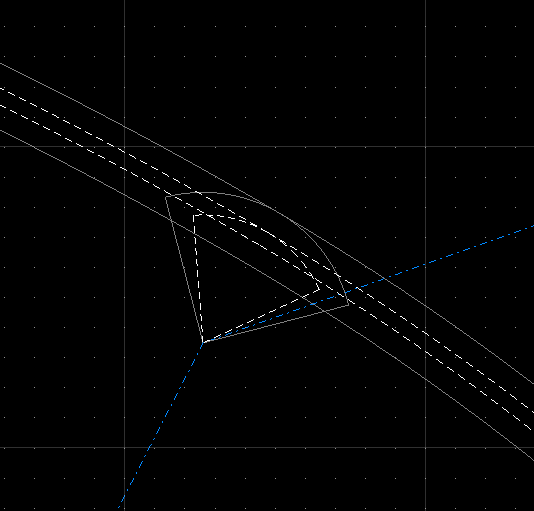

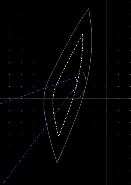

About the offset Lead-in and Lead-out.
Already reported in detail here:
https://www.qcad.org/rsforum/viewtopic. ... 206#p44206
I called them "donkey ears".
The entry and exit paths can indeed ruin your piece.
It is not limited to eighth of circle: https://www.qcad.org/rsforum/viewtopic. ... 107#p45107
The Bug report is here:
https://qcad.org/bugtracker/index.php?d ... sk_id=2558
Remark the "Won't fix" but I filed a request to re-open the task.

Post by andrew » Wed Jul 10, 2024 7:40 am
cool.occd: Thanks for your detailed report.
I've opened a bug report at:
https://qcad.org/bugtracker/index.php?d ... sk_id=2584
Posts: 8816
Re: Mill VS Laser VS *NEW* Plasma tool
Post by andrew » Wed Jul 10, 2024 7:57 am
I can confirm that this should be fixed for the next release. The start point of the offset toolpath should only coincide with the start point of the original toolpath if G41/G42 is used.
