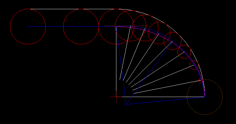

Because it is NOT POSSIBLE to compensate an Arc entry gradually with another Arc-like path.
Most drivers can not cope with the true trajectory of offsetting an Arc from zero to Rcutter along the Arc.
Supported G-code is typically limited to G0, G1, G2 or G3.
G41-Arc compensation.png (11.49 KiB) Viewed 21617 times
In the above the blue arc is a 3 point arc connecting the compensated cutter centers at 0-45-90°.
It doesn't connect tangentially to the horizontal blue path and doesn't match with other cutter center positions.
:arrow: The bulge of the blue central path would result in an over-cut for the entry path :!:
In magenta I added 1/4 of an ellipse, the only shape that will be tangent at start and end but it doesn't match with any other center position.
The true trajectory that connects the compensated cutter centers is a part of some spiral function.
Typically UNSUPPORTED.
Common in G41/42 trajectory visualization is that the center path and the edge of the cut area start at the same point.
As if the cutter grows from R=zero to R=Rcutter along the entry trajectory.
I find the visualization of curved compensation paths in QCAM incorrect or at least misleading.
An offset to those central paths by Rcutter may even result in over-cutting.
A hunch ... I can not verify that with my CNC setup.
'As is' QCAD/CAM only supports plunging straight down and cylindrical cutters.
Plunging at the start of the entry move results in the orange dotted representation of the cutter.
The cutter edge is not matching with the cut area in white :!:
Plunging at the end of the entry move is no longer a circular motion that gradually approaches the area to cut :!:
Only plunging after a straight pre-entry move is correct.
