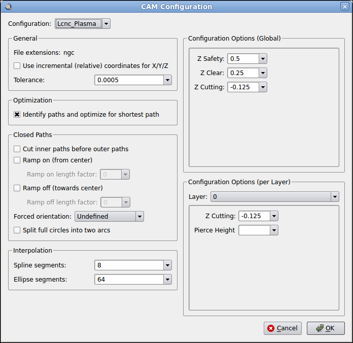

I managed to add a combobox to the ui but am failing to get it populated with some defaults.
Screenshot-CAM Configuration-1.png (79.27 KiB) Viewed 50819 times

Posts: 8785
Re: Adding Options to the CAM Configuration Page
Post by andrew » Mon Nov 11, 2013 7:05 pm
Note that the name that is references in the .js file ('PierceHeight') has to match the object name that is defined in the .ui file. Feel free to post the .ui file if you can't get it to work.

The problem is that there are two methods called "initLayerOptionWidget" in Lcnc_Plasma.js (lines 43 and 82). The second one simply overwrites the first one.
I've noticed that you are changing 'GCodeLayer.ui'. It would be better to copy and modify that file to add custom options. You can name it whatever you like, but following the current naming convention it would be called 'Lcnc_PlasmaLayer.ui'.
You can then set the name in Lcnc_Plasma.js:
