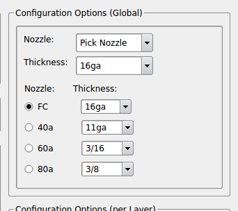

I'm trying to figure out a way to limit the thickness list for each nozzle. So I came up with using a radio button for each nozzle and next to it a combo box that only list thickness that would be appropriate for that nozzle. What I'm having trouble with is finding out which radio button is checked.
CAM Configuration.png (20.69 KiB) Viewed 15343 times

Anyone have an idea on how to get the currently selected radio button? I've searched and guessed till the cows came home...

If you assigned the object name "MyRadioButton" to a radio button, its value should be available as property with key "Cam/MyRadioButton":
layer.getCustomProperty("QCADCAM", "Cam/MyRadioButton");

It is a global option so I get errors trying to use layer.
I'm calling the function from writeToolDown:
// probe for material top and fire the torch
Plasma.prototype.writeToolDown = function() {
    this.g = GCode.Mode.Normal;
    this.z = this.getToolDownLevel();
    this.nozzle = this.getNozzle();
    this.thickness = this.getThickness();
    this.settings = this.getCuttingInfo(this.getNozzle(),this.getThickness());
    qDebug("radio " + this.getRadio());
    this.toolIsDown();
I tried many things including this:
Plasma.prototype.getRadio = function() {
  var layerId = entity.getLayerId();
  var layer = this.document.queryLayer(layerId);
  qDebug("button group " + layer.getCustomProperty("QCADCAM", "Cam/radioFC"));
  return;
Thanks for your help
