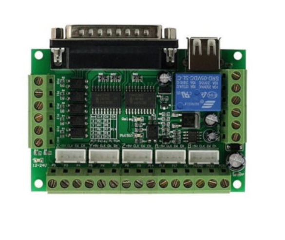

HI
I removed the controller, which came with the laser cutter and changed to it with stepper controllers.
It's a generic parallel port controller controlling MACH3.
GRBL also uses the same way, which changes PWM duty with [S] parameter.
I think it's a pretty generic PWM controller.
Thank you
Chris
