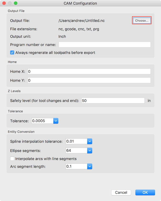

From a QCAD/CAM user:
How can I change the output file name for the G-Code output?
Posts: 8786
Re: Change output file name
Post by andrew » Mon Feb 05, 2018 4:03 pm
You can change the output file under CAM > CAM Configuration > Output file [Choose]:
Screen Shot 2018-02-05 at 15.02.40.png (115.99 KiB) Viewed 7661 times
