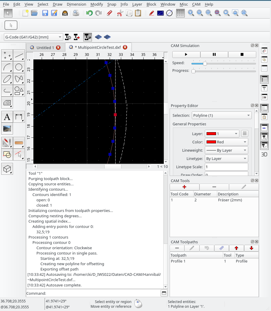

no problems to cut circles from QCAD. Trying to create gcode from the example appended brings many problems. The cutter jumps cutting cirles, see pictures. You can test it easyly with my appended dxf file.
I tested if countour is closed using hashures, no problem, no open forms found.
Could you support please?
Best Regards,
Christof

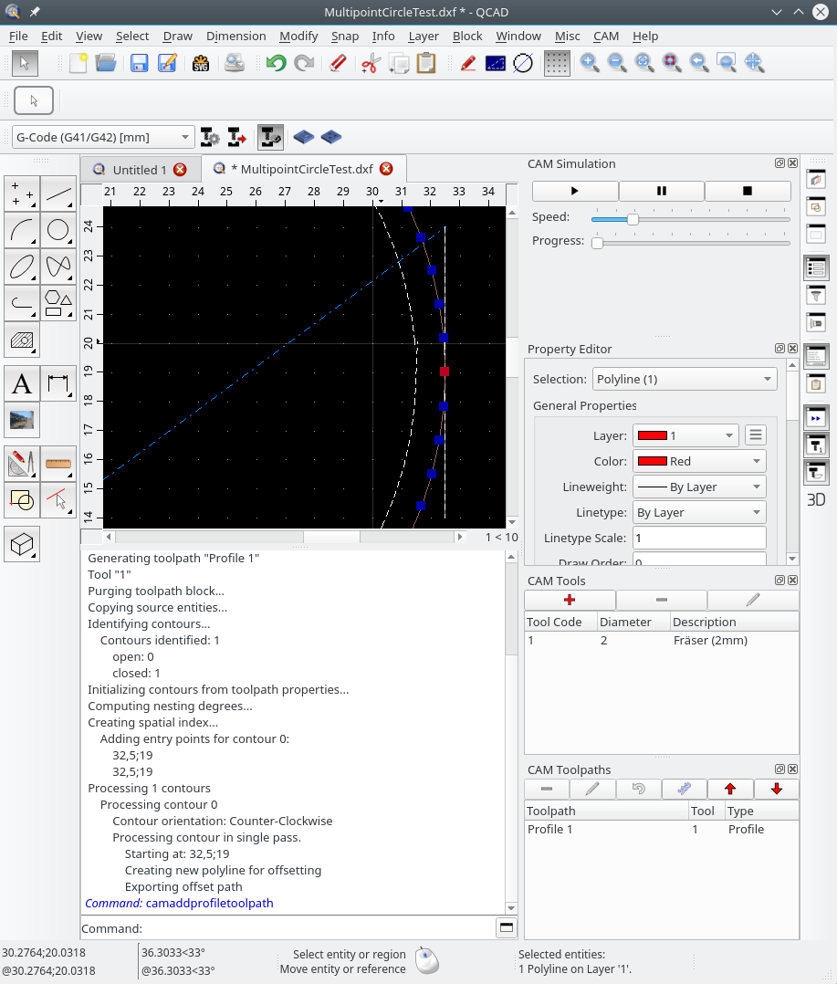

maybe I found a possible hint: the suchcalled entry point is calculated independent (I respect only my examples) of choosing cutting inside or cutting outside the contour. In every case its the same coordinate.
here I selected cutting inside:
here I selected cutting outside:
Hope it's helpfull finding a solution.
