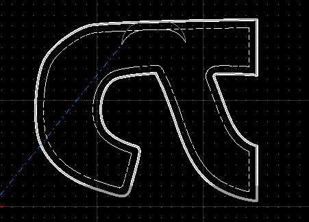

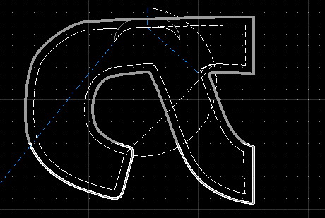

Hi folks,
have a look to attached contour.
If i choose a tool diameter of 1.5mm the toolpath makes a weird jump, if i increase to 1.505mm the toolpath is OK.
Any ideas on this ?
CAM toolpath jumps in dependence of tool diameter

- Posts: 8786
Re: CAM toolpath jumps in dependence of tool diameter
Thanks for your report. This problem has been fixed in the latest development version of QCAD/CAM. If you can indicate what platform you are on (Windows, MacOS, Linux, 32bit / 64bit), I can issue a snapshot release for you to try.

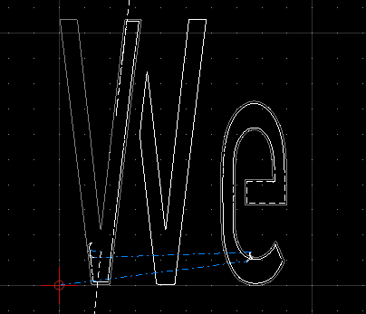

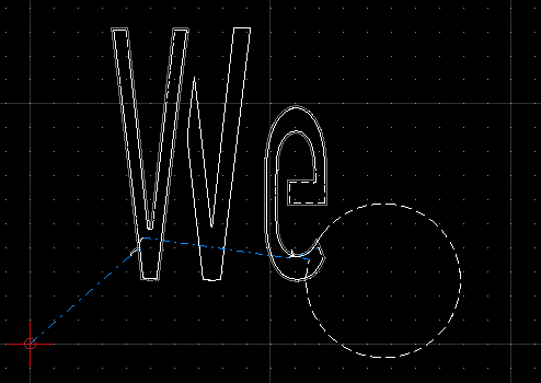

Here i have another problem ... don't know if this is 100% related to the last one. But there are different (even weird) toolpaths generated with the different versions.
3.19.2.6 3.19.2 Any ideas on this?

- Posts: 8786
Unfortunately, these polylines are rather messy with duplicate and triple nodes and many virtually straight arc segments with huge radii. Presumably these are the result of exploding a text. Some fonts contain glyphs with such problems which makes them unsuitable for further processing without some clean up work.
I would recommend to either re-draw these polylines from scratch or clean them up using:
Draw > Polyline > Arc to Line Segments
Draw > Polyline > Normalize
Draw > Polyline > Simplify
Relocating the start point of a polyline helps with lead-in, lead-out problems.
Hi andrew,
many thanks ... that did the trick ... now i have a perfect toolpath.
QCAD is really cool !
