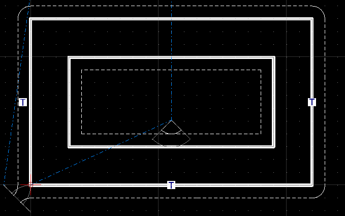

I experimented a little bit with tabs. Everything is ok when using tabs at pieces with great distance between lines (I don't know which one).
Smaller work pieces (I attached my test object) have problems. The two tabs at the outer line are as well influencing the two inner lines.
Did I misunderstood the use of tabs?
Best Regards,
Christof

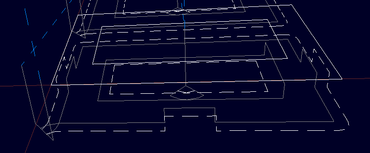

to my todays new example:
Right side: tab on line -> inner line impacted -> NOT OK
Left side: tab beside line -> inner line NOT impacted -> OK
Hint: I don't know why the tab in the middle of the lower line doesn't impact the inner line!?
So: the impact area is not a radius but something like a rectangle I assume.
see 3D-View below:
