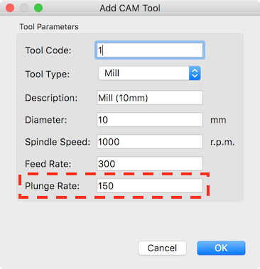

The Z feedrate is labeled as "plunge rate".
The default plunge rate for a tool can be defined in the dialog when adding a tool:
Screen Shot 2018-09-10 at 08.59.15.png (50.33 KiB) Viewed 7747 times

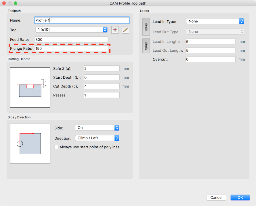

When creating a profile toolpath, the plunge rate can be adjusted for that particular profile if desired:
Screen Shot 2018-09-10 at 08.59.26.png (122.82 KiB) Viewed 7747 times
