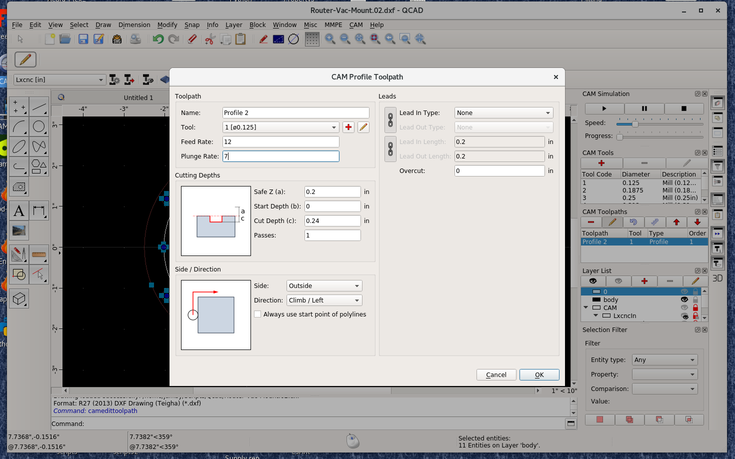

This model has one tool bath but is running both inside and outside during it. The model was edited several times and at one time, with two tool paths it did do 1) all inside cuts 2) another that did the outside cut.
Don't know if this is a display problem or something wrong in the tool path.

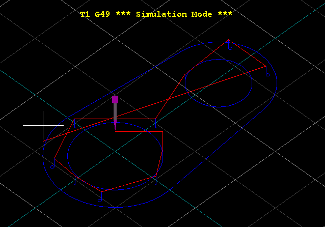

Your ngc runs fine: It cuts all the insides CCW, followed by the outside CW.
Constructor to constructor:
I am not aware how you clamp this, but cutting out large pieces without bridges troubles me.
For these shapes even with a vacuum table.
Plunging 2x the cutter diameter and straight down troubles me.
The smaller holes I would cut helical, that doesn't clog your cutter.
Going up after each cut I would expect a G0. The faster your out of cut the better.

MDF 1/8? You plunge from Z0.2 to Z-0.24, I am asuming that zero is the top of your material.
Dhole 0.15 & Dtool 0.125 = Smoke

Here's a second copy and a screen dump of the file open on my screen.
Thanks
Jim
