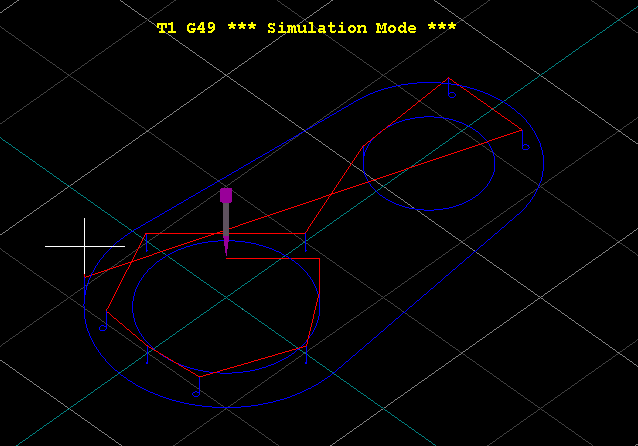

This model has one tool bath but is running both inside and outside during it. The model was edited several times and at one time, with two tool paths it did do 1) all inside cuts 2) another that did the outside cut.
Don't know if this is a display problem or something wrong in the tool path.

Your ngc runs fine:
It cuts all the insides CCW, followed by the outside CW.

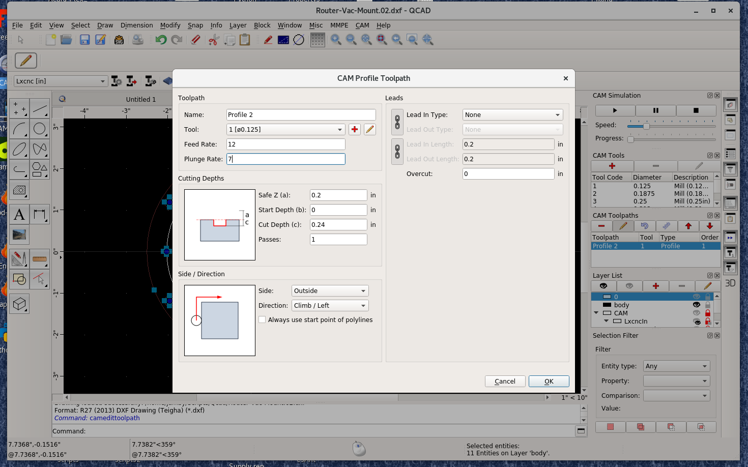

Posted: Tue Nov 24, 2020 8:13 am
jamby: When I load the DXF file, the two toolpaths you mention are empty (presumably deleted?). Can you attach the file with the toolpaths? I can create a new toolpath just fine but I would need to know the exact parameters / geometry you have used.
Re: Odd behavior from just one tool path
Posted: Tue Nov 24, 2020 8:05 pm
by jamby
Andrew
Here's a second copy and a screen dump of the file open on my screen.
Thanks
Jim
