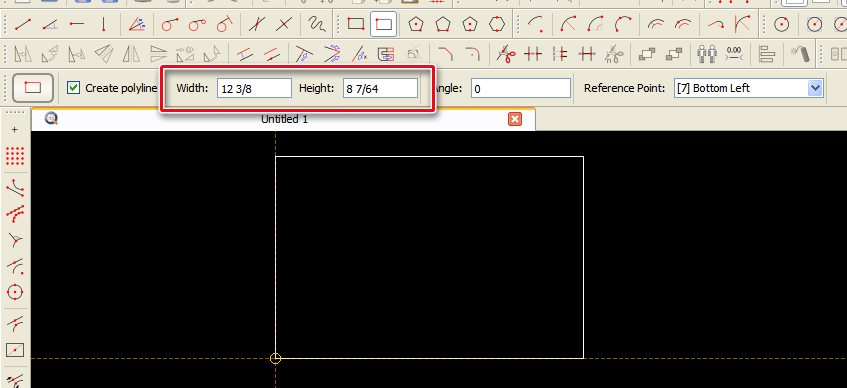

No need to see additional fractional information in the Status bar - unless you are just guessing the measurements ...
May I ask you why? If I draw a line, rectangle or what ever I just need to put in my fractional dimensions. E.g rectangle width 11 3/8 and height 8 7/64.donwiss wrote:When I draw something I need to see fractions along the bottom.

Okay. That makes a lot of sense. That would be the way that I input it.
As you can tell I am a total neophyte when it comes to CAD. But on my screen, when I make the Rectangle the active tool, I see the Create polyline check box. I check it. But none of the other input fields appear to the right of the checkbox.

Okay. I get it. Thanks. I also found why there were no dimensions when I had the Rectangle active. There are two Rectangle tools. I just had to select the second one.

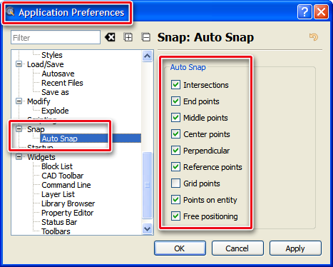

I'm now trying to figure out Auto Snap. I don't want to snap to any artificial grid. But in flooring all shapes have to touch the adjacent shape. And often to the corners also.

Good idea! Get familiar with the snap tools - you need them all the time. If you like to check out what are the settings for the "Auto snap" tool go to "Edit / Application Preferences:donwiss wrote:I'm now trying to figure out Auto Snap. I don't want to snap to any artificial grid. But in flooring all shapes have to touch the adjacent shape. And often to the corners also.
Tick / Untick what ever you like to have on your "Auto snap" hands!
