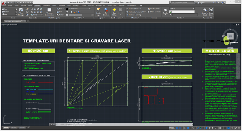

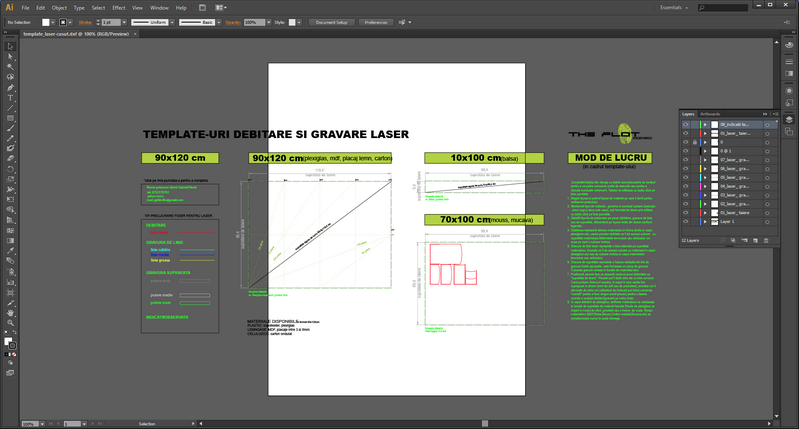

Hi gabbello
Your file opens fine in AutoCAD 2016 and Adobe Illustrator Cs6 - no problems for me.
In AutoCAD.jpg (309.8 KiB) Viewed 12394 times
In Illustartor CS6.jpg (163.03 KiB) Viewed 12394 times
Who is using the 'other software' you or the guys doing the laser cutting?
