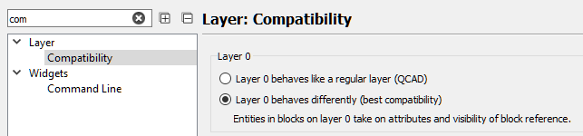

The differences are compatibility.
Refer to: Application Preferences .. Layer .. Compatibility.

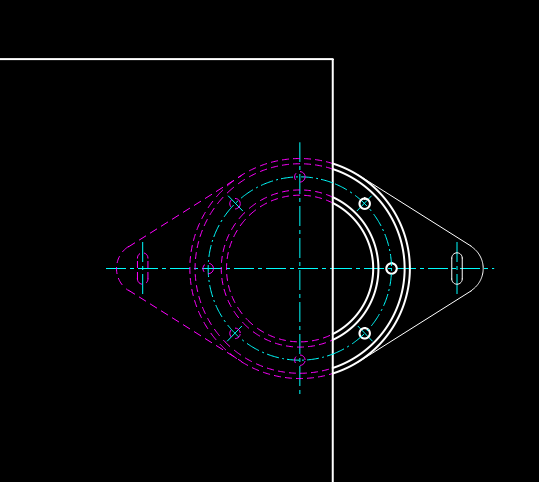

A drawing is a tool of communication. It has to speak a language which is understood on both sides. The designer and the reader. For those reason there are rules like for what is which Linetyp and which Lineweight used. Example: As a "Center line" is used the Linetyp Dash/Dot and for a "Hidden Line" is used a Dashed Line. If you use a Continuous Line for a center line the information is lost for the reader. This said - these are very important information and for a stress less communication absolute crucial. If you design a drawing or a block and step away from those rules a drawing becomes worthless. With other words - yes you should use different layer for blocks or find a different way to communicate those information like individual Linetypes.
However - there are different ways to skin a cat. Here is my style to work with blocks. Maybe it works for you too .... maybe not. :shock:
Blocks: I hate to deal with stacked blocks and most of the time I don't see a benefit to stack them. For those reason mostly every block in my drawings is autarch what means it is a single block. Of course it could be that I need multiple blocks to build such a block but finally I explode everything in that block to get rid of the stacked block hierarchy.
Layer in Blocks: It is necessary to think about for what that block is used. Most of the time it is possible that depending on which Attributes on what entities are used they need to be changed in the main drawing. Example: A "Flange" placed in front of an object needs to have continuous lines for the contour but placed behind an object those lines have to be dashed. That is how a designer can tell a reader that the flange belongs behind the object ...
Sure, you can place the block in Model_Space, explode it and then change those attributes to what it need to be. Lazy me - I try to avoid that with a "smart" block layer assignment what is easily to do with QCAD.
Block Layer.gif (1.22 MiB) Viewed 34279 times

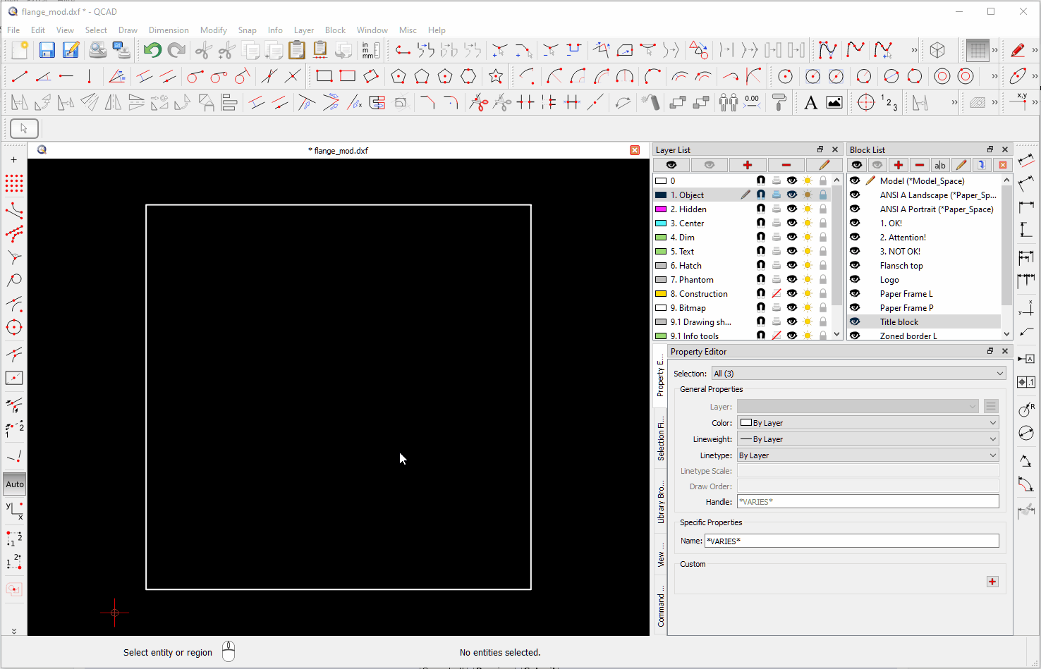

Is this a "one fits all" solution? No! If I have in this example to place the Flange only half behind an object I have to step in and explode that block to change those line information accordingly. Sucks .... but you can't have it all! On the other hand - not a big deal in QCAD! 8)
Half covered
Here my challenge to @massimo, @ryancousins ... and everybody else who likes to play with it.
Try to create a block of the Flange with the functionality shown in my animated gif. All information what you need to know are in this Topic and I only used layer ... :wink:
flange_mod.dxf
(107.09 KiB) Downloaded 7284 times

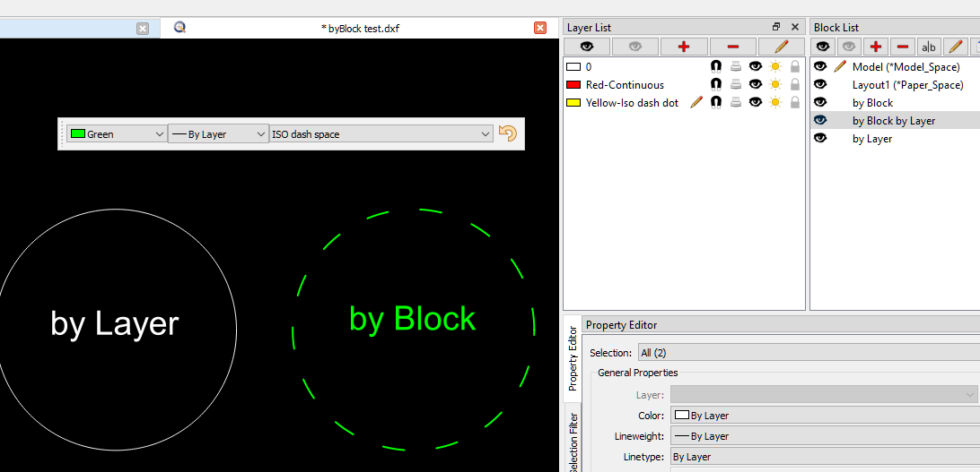

This "By Block" assignment is very frustrating to me too. My research brings me to the conclusion that the "by Block" assignment in QCAD fails or there is a different approach behind that what is unfortunately nowhere explained ...
What I found describing the "by Block" assignment in big CAD packets is in short:
"By Block" is meant to define attributes "on the fly" during inserting a block. With other words - no color, line weight or line typ is assigned to those chosen entities in a block. During inserting you have to chose those attributes which will then be adapted by "by Block" entities. I assume that part of this misconception is that we know how a layer assignment works with a clear definition of all attributes ... well, "By Block" has no immediate attribute assignment in the first place!
This said - there are a bunch of examples out there which will explain how it work. Nice - the only problem is it isn't working that way in QCAD. Honestly - I don't know why! As I already mentioned - It could be a bug or a different approach.
My last example which fails in QCAD too is very simple. Block of two circle, drawn on Layer 0, left circle assigned "By Layer", right circle assigned "By Block". Inserting into Model_Space affects both circle equally. Active Layer has no effect (left circle should be yellow / dash dot). That is not how it is described on many pages in the www for a "By Block" assignment ...
If I change Application Preferences to "Layer 0 behaves like regular Layer (QCAD)" then I get a clear result - works as expected ...
... but I lost the functionality of using layer 0.
Probably I missed something important? In that case - please enlighten me!
byBlock test.dxf
(105.19 KiB) Downloaded 7300 times
