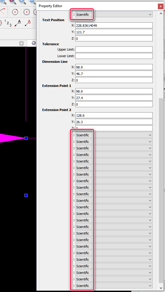

I have the feeling that some kind of data association is incorrect.
Why?
New drawing ...
1. Drawing Preferences / Dim Label Format = Decimal
creating a dim / selecting = Property Editor reads that it is a Scientific dim ... two times.
2. Then changing the "Size scale factor" in Drawing Preferences / Dim from 1 to 10 or vice versa will flood the Property Editor with Dim Label fields ...
@ Andrew
That happens in CE 3.27.8.0. Maybe you can find the time to look into this. Thanks.
@botobi
I'm not sure that the change in a dim "Size scale factor" is program intern actually used to change the dim scale factor.
I'm sure Andrew has a better answer than me to that question ...

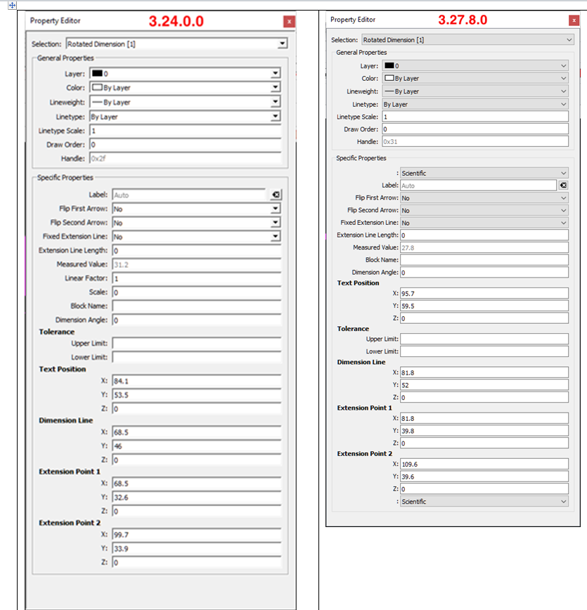

There‘s another issue: In the previous version, when I selected a dimension, I had a "dimension scale factor" field in the property editor. With version 3.27.7 the "dimension scale factor" field in the PE has disappeared.

Correct but it can break at any time. However - if that happens I still noticed after editing the scale in DP/dim some kind of respond within the dims in the drawing. Not a scale change but a actualization of the dims or even a change in dim text color. That means QCAD CE is still trying to process the changed information but for some reason fails ...
Correct - "Scale" is missing and two incomplete fields for "Linear Format" are now listed. The order makes no sense to me and it also doesn't represent the correct settings below Drawing Preferences. Set is Decimal and the PE tells as it is Scientific.
This said - this is nothing which can be fixed with an adjusted program setting etc.. This goes to the core of the programing which is out of my hands.

The specific difference between 3.24.0.0 and 3.27.8.0 would have occurred before version 3.26.4.9
At that time Andrew implemented Style overrides.
I have this logged in Centroids, that used document properties to get the dimension size for the Centroid label.
Husky reported that this didn't work under 3.26.4.9 and I changed all that code to read Style data (With the hints from Andrew).
Surely there is something wrong with the Property Editor in CE and the handling of Style overrides.
One should report this as a CE bug.
