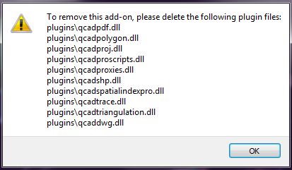

qcadproxies.dll needs also to be removed !!!!
Qcad community edition needs more files to be removed

The list in the related topic Removing the Trial Add-Ons is indeed incomplete.
Issued on Fri Jan 13, 2017 and probably not updated meanwhile.
This issue is already mentioned several times.
The topic is locked and as QCAD users, as QCAD forum members, we can not update, comment or reply to that.
At present this dialog is presented on Windows when you want to revert to QCAD CE.
That lists 2 extra DLL files to be removed.

Update: Qcad community edition needs more files to be removed
The content of the related locked topic was rephrased by Andrew.
A list on the QCAD CE forum was practical when QCAD is not running.
Or when you merely downloaded the package of a new release.
Plugins can be removed/renamed when QCAD is running.
I must add that I have no trial packages installed under C:\Program Files using Windows.
After the limited trial interval or limited number of sessions another dialog would pop up.
That was the reason I took a screen capture as PNG, updating it on regular base.
If considered as solved, please add [SOLVED] to the title of your initial post by editing it.
