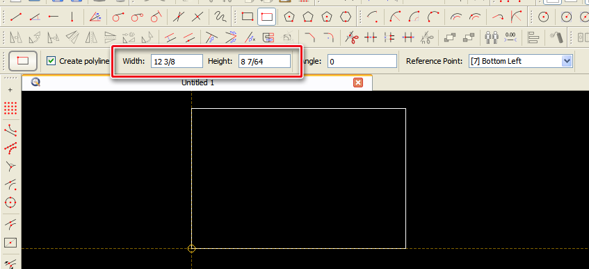

Hi
donwiss wrote:When I draw something I need to see fractions along the bottom.
May I ask you why? If I draw a line, rectangle or what ever I just need to put in my fractional dimensions. E.g rectangle width 11 3/8 and height 8 7/64.
No need to see additional fractional information in the Status bar - unless you are just guessing the measurements ...

As you can tell I am a total neophyte when it comes to CAD. But on my screen, when I make the Rectangle the active tool, I see the Create polyline check box. I check it. But none of the other input fields appear to the right of the checkbox.

Okay. I get it. Thanks. I also found why there were no dimensions when I had the Rectangle active. There are two Rectangle tools. I just had to select the second one.

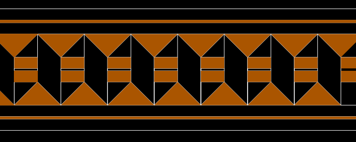

After I draw a rectangle, at times I want to collapse one corner and turn it into a right triangle. Or collapse a corner part way, to turn the shape into a parallelogram. In flooring there are only five shapes: rectangles, right triangles, parallelograms, Isosceles trapezoids, and right trapezoids. Sometimes the shapes are rotated 45°. Angles are almost always 45°.
I have been knocking them out on paper and then scanning them. I'm not allowed to post web links here. But if you add the usual extension to facenailedfloorborders you can see examples. I just started this project. It could be endless. Brooklyn has many homes with pretty floor borders.

donwiss wrote:After I draw a rectangle, at times I want to collapse one corner and turn it into a right triangle. Or collapse a corner part way, to turn the shape into a parallelogram. In flooring there are only five shapes: rectangles, right triangles, parallelograms, Isosceles trapezoids, and right trapezoids. Sometimes the shapes are rotated 45°. Angles are almost always 45°.
I think I get the idea ... and it is very easy to draw something like that with QCad:
donwiss wrote:Brooklyn has many homes with pretty floor borders.
I checked the website - very nice borders! 8)
