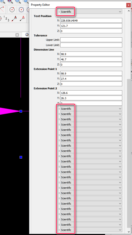

the Property Editor goes crazy too ...
The PE seems fine in 3.27.6.0
2 new properties were added in .7 ... What with .8?

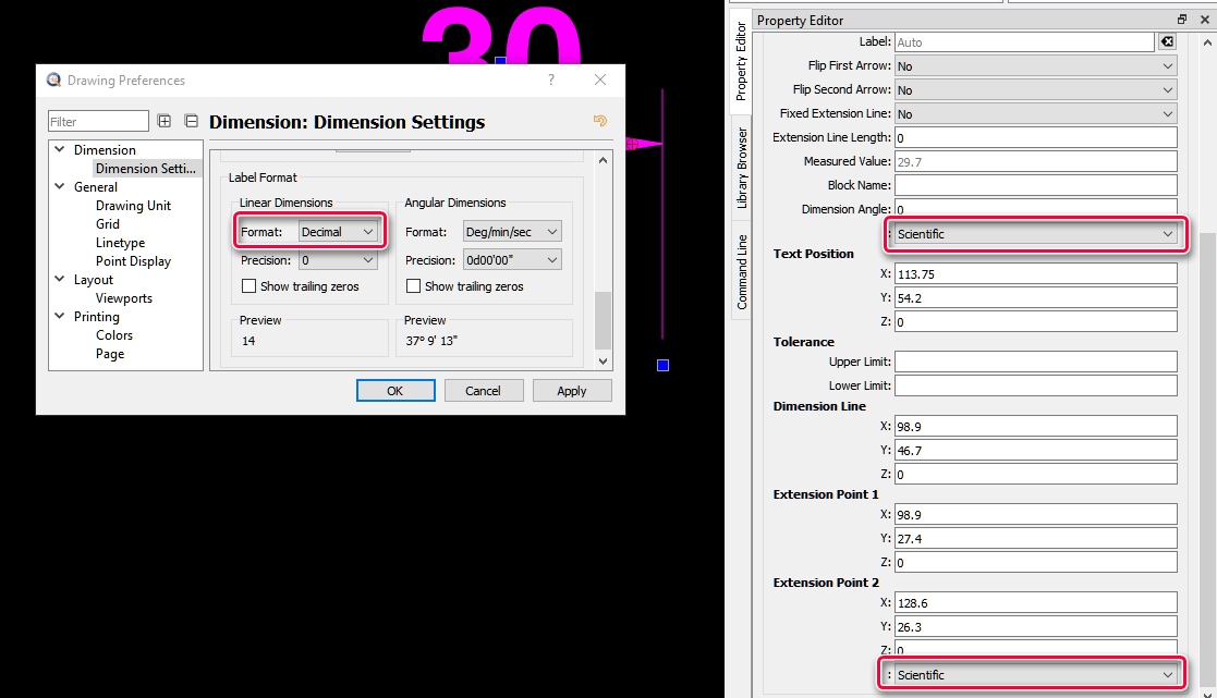

New drawing ...
1. Drawing Preferences / Dim Label Format = Decimal
creating a dim / selecting = Property Editor reads that it is a Scientific dim ... two times.
2. Then changing the "Size scale factor" in Drawing Preferences / Dim from 1 to 10 or vice versa will flood the Property Editor with Dim Label fields ...

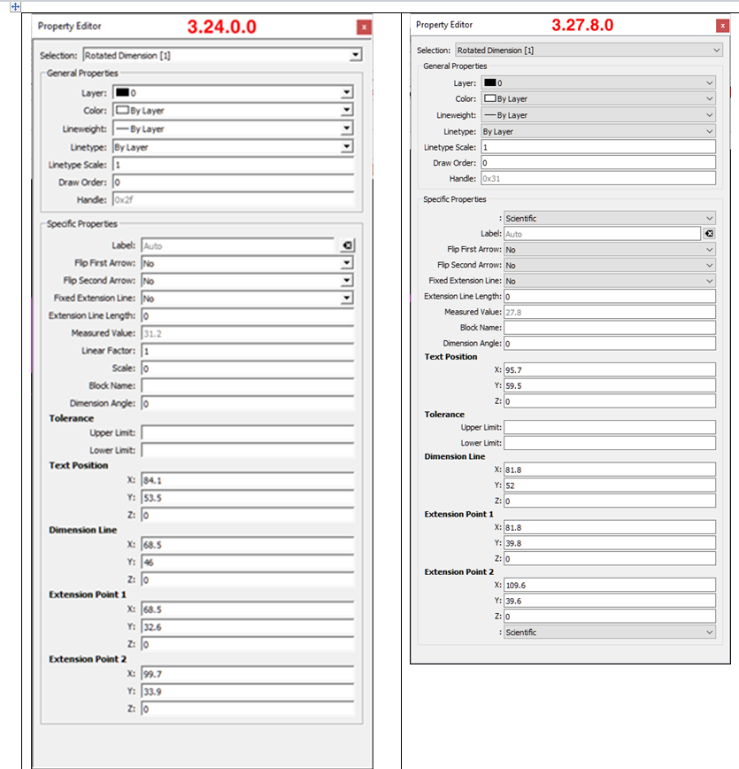

There‘s another issue: In the previous version, when I selected a dimension, I had a "dimension scale factor" field in the property editor. With version 3.27.7 the "dimension scale factor" field in the PE has disappeared.

botobi wrote:
Fri Oct 07, 2022 9:08 am
Correct - "Scale" is missing and two incomplete fields for "Linear Format" are now listed. The order makes no sense to me and it also doesn't represent the correct settings below Drawing Preferences. Set is Decimal and the PE tells as it is Scientific. e_confused
This said - this is nothing which can be fixed with an adjusted program setting etc.. This goes to the core of the programing which is out of my hands. :oops:

Fri Oct 07, 2022 10:23 pm
Same here: https://www.qcad.org/rsforum/viewtopic. ... =15#p38107
And there is a kinda fix for it but wendi reported that arrows turn into architectural ticks. :roll:
Nothing was fixed at that time (See GitHub), that topic was moved to the CE forum by Andrew.
https://www.qcad.org/rsforum/viewtopic. ... =15#p38105
