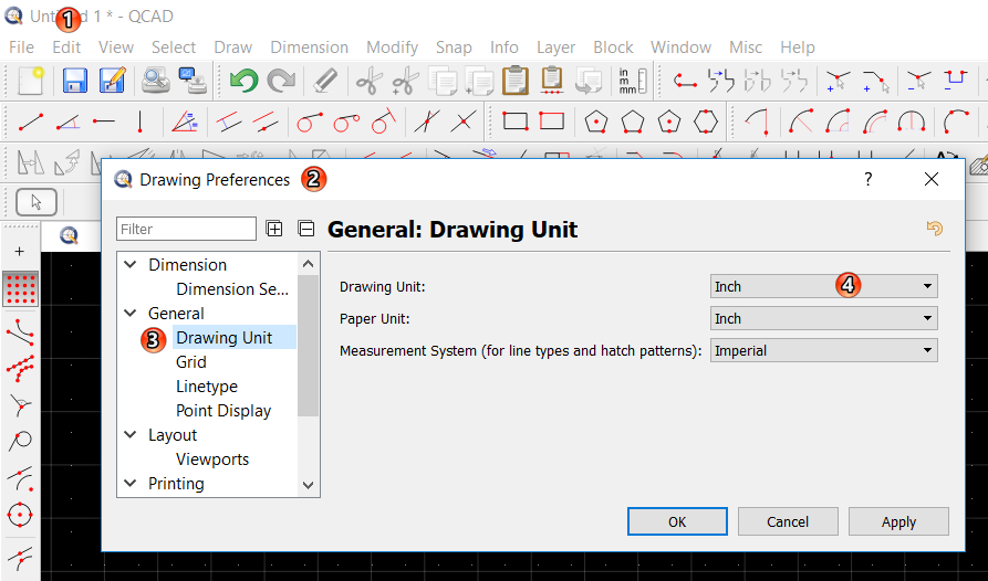

Yes. Make sure your Drawing Unit is inch. You will find the settings for the actual drawing below Menu / Edit / Drawing Preferences:
Then below "Grid" you can fill in what ever you need - QCAD accepts Decimal, Fraction and simple mathematical expression:

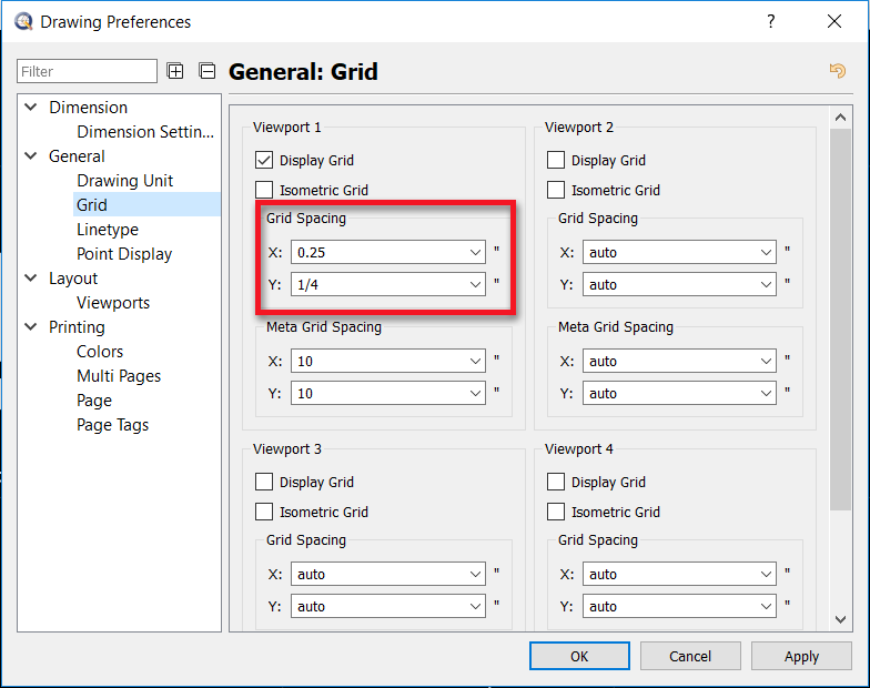

I tried that but it doesnt behave as expected. For example, for the drawing prefs, I set the units to inches (always) and the x grid and y grid to 1/4 .

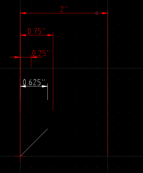

Then at high zoom levels, I see grid spacing of 0.625" and that is what the SG snaps to. Ive tried to capture all of this in one screenshot. Note I set the metagrid x,y to 2" and it looks right and thus not aligned with the grid because 2.0 is not an integer multiple of 0.625 .
It seems I have to zoom very high to get it to render the grid at 0.25" .
Is that the right behavior? I would expect, at least, if it has to render the grid more coursely, it would do so in multiples of the grid setting.

Thanks for the drawing!

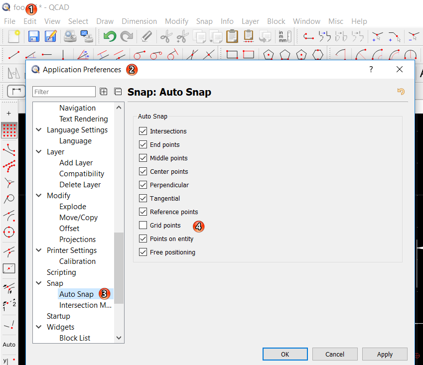

The messurement in your drawing (0.625) isn't snaped to a grit point. My test dims are showing what is expected.
Note: A visible grid doesn't means it will snap to those points. It needs to be turned on ....
... or you have to include it in Auto Snap
Keep me posted how it turns out ... :wink:

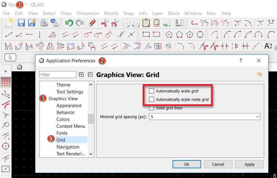

I played a little more with the Zoom ....
aberezin wrote:Is that the right behavior? I would expect, at least, if it has to render the grid more coursely, it would do so in multiples of the grid setting.
... and I have to agree - that is a kind of odd.
I assume that has somehow to do with the "Automatically scale grid" but I'm sure Andrew can tell you more about that.
It snaps correctly when you turn off "Automatically scale grid" below:
