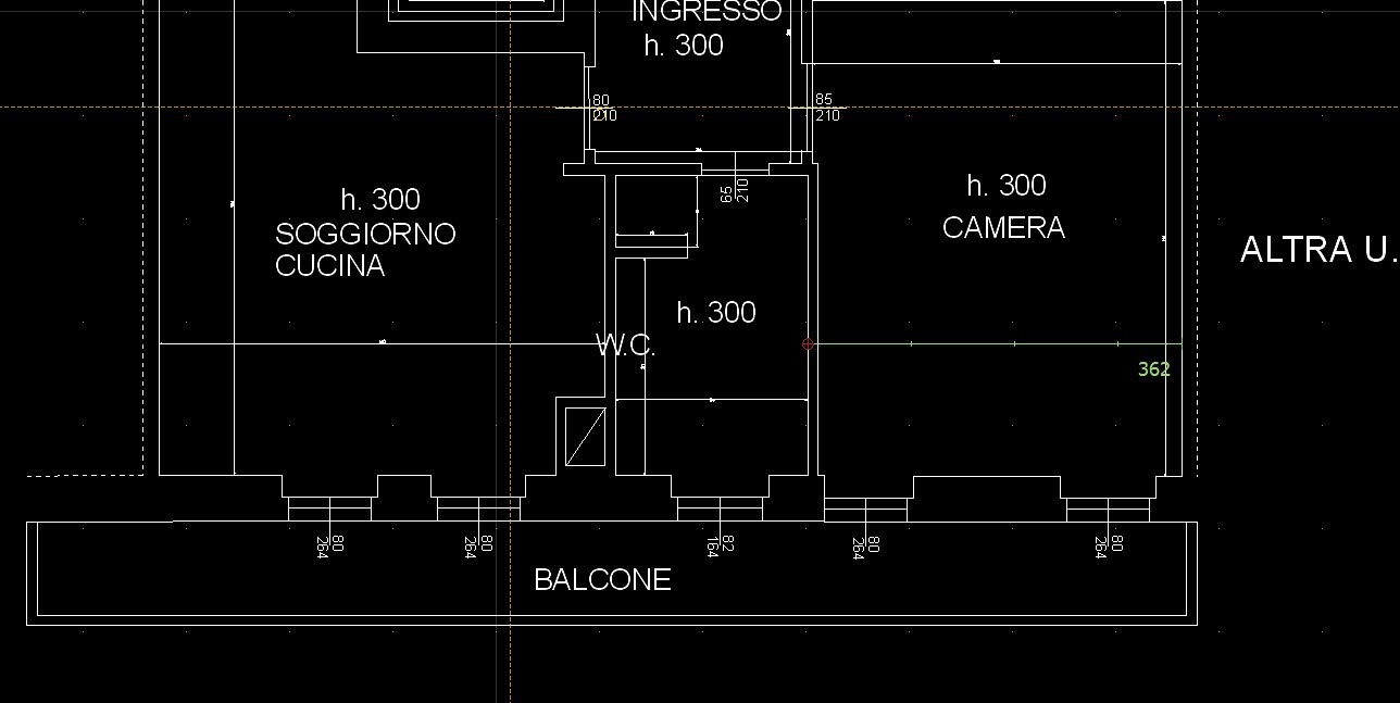

devo presentare un progetto al comune in scale 1:100, nella foto allegata ho il disegno in millimetri su CAD della planimetria, invece nella foto cartiglio il cartiglio a4, in scale 1:100.
Come faccio a fare copiare la planimetria e a scalarla correttamente in scale 1:100?
come si adeguano invece le quote?
Ho visto la guida, dove si va su preferenze disegno... ma non riesco o forse sbaglio qualcosa... per il mio caso specifico è così difficile scalarlo in scala 1:100? sono in difficoltà.. spero qualcuno mi possa aiutare

Please find attached Qcad file.
I made an order 1, 2 and 3.
1 it is the right scale 1:100 where I should scale properely 2 and 3.
How can I do?
problem with 3 it is that quote are in meters and the mesurement are not right... because file was corverted from pdf to dwg

Just a few remarks:
It is common to draw in real life measurements ... Scaling the printed view is the paper side of the story.
The drawing unit of the file is 'None'.
2 is in cm
3 should be scaled up by an average factor of 9,11 to be in cm.
But that will never be fully correct in both X and Y.
1 represents two A4 pages in cm.
To fit 2 and 3 on 1 they need to be scaled by factor 0,01 ...
But I would not do that, I would use a paper scale.
One of the reasons is that the dimensions are then in meters while other sizes in 2 are text in cm.
Beside that 3 is a textual mix of cm and meters.

I agree.
How do you convert to 1:1?
- Posts: 4955
Re: problemi con scala presentazione progetto
It all depends on what measurements are convenient or on what is required or what is standard.
Common is 1:1 but there is no unit mentioned in that.
Engineers may use mm, your architect uses cm or meters, land-surveyors may use meters or kilometers ...
So first you need to decide on what the drawing unit is.
Now , let's assume cm.
Set the Drawing Preferences unit to cm.
2 is already in cm.
Scale 3 by selecting all, Modify .. scale and indicate a focus point (no copy, factor 9,11).
But as already mentioned, 3 is a textual mix of cm and meters.
You then need to edit the meters quotations or replace them by dimensions.
When we print 2 or 3 on an A4 then select a paper scale of 0,01 or 1:100 what is the same.
Lotto 5 ... Original quotation 6,93 (in m) or about 693cm (692,818293) will be printed 6,93 cm wide and thus in scale 1:100
It is all very similar when in mm or in meters.
The only thing that changes are the factors.
Once every textual quotation and/or dimension matches the drawing unit one can convert between units.
