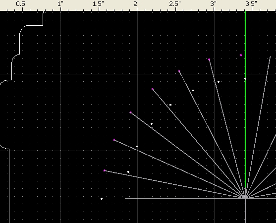

For some reason, when I tried the second (inner) path using Clive's method something went awry. :/
And yes, I double checked my numbers and did all the math in an excel spread sheet to so I had all the required distance marks in place. But...it didn't seem to line up properly to me. (The points represent peg-holes for a cribbage board)
In the image, you can see the PINK and White points make a nice arcs, half of what I need, however they are still a bit off.
- The White points do not line up between the center-point and their corresponding point on the outside.
- The Pink point on the top doesn't line up perfectly with the green center-line like the white one does.
- The spacing isn't quite right yet either. The outside bottom white point is the last hole in the prior series of 5 peg holes. So, that being the last spot before the next series of '5', where the turn begins, I need to delete the first and last pink point.
...I'm not sure why. It might be that I shortened the number used for measuring the distance points. The coordinates initially came back with 6+ digits to the right of the decimal, but I shortened them to 3, thinking anything beyond that probably wouldn't matter. (I'll try to re-do it all again tonight and see if I get different results.)
My rational behind this (If you play cribbage you will understand, if not I can whip up another JPG to upload)
#1) I needed 10 points to drill across an this 180 arc. To ensure that they would be evenly spaced for this curve, I thought I would need 13 points. 10 points for the peg-holes, and 3 points to mark the spacing between the series of 5 = [space] + [5points] + [space] + [5points] + [space].
...but (shrugs) it didn't come out the way I thought.
need to and I need to adjust the spacing so there are 5 evenly distributed holes (points) between that and the green center line.

This is what I'm talking about:
But - honestly - I don't understand why you have to work with distances on the arc. To make it correct you have always to calculate the radius for the arc before you draw it - otherwise it will never suit both criteria - distance and number of holes ...
I would just work with angles ... :shock:
Please do me a favor. Attach your dxf file with this two paths example and tell me exactly how many holes do you need on this 180° arc.
I like to show you my solution for this problem, ok?

Post by Sterling » Mon Dec 08, 2014 6:04 am
Howdy -
So, to further expand my situation (and try to learn), i have discovered that making these points on an Arc is different than trying to make them along a shape that was drawn by a bunch of short lines.
To clarify - I have drawn an apple (for a school teacher - not the electronics corporation), and I want to intersperse it with points. I used the "Line From Two Points" tool (LI), to draw it, and now I have approximately 60 straight lines that make up the apple.
In reviewing what has been posted earlier, It seems to me that CLIVE'S options might work=
Clive wrote:This may help.
Try placing your points using the snap to entity option and the snap distance option, if you know the distances between one end of your Arc, Circle, Spline etc. and the points in sequence, you can simply type them into the Snap distance field :wink:
*Note if you are placing points around a Circle using this method you will need to divide the Circle (Modify -Divide) into two arcs.
(Heh-heh) I'm sure you gents already knew that it wasn't going to work out~!
As I sift through the 'Help' file, I realize I'm not educated on this. I'm not coming up with something that I could understand. Is there a "Merge" or "Join" function that would bring all the line segments together so I can use Clive's process? Or not? Have I unwittingly created an entirely different situation?
Once again...thanx in advance for your time!
In confusion...
~Sterl~

Post by Clive » Mon Dec 08, 2014 10:58 am
Sterling wrote:As I sift through the 'Help' file, I realize I'm not educated on this. I'm not coming up with something that I could understand. Is there a "Merge" or "Join" function that would bring all the line segments together
You can create a continuous Polyline from seperate line, arc segments, use the-
Draw > Polyline > 'Craete from Segments' command.
