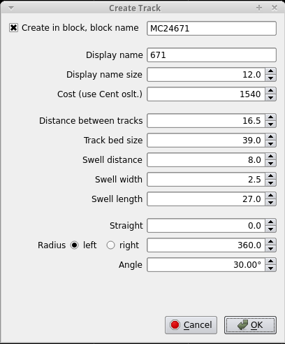

To create a new track part, select "Create" from the QCTrack menu. The following dialog will appear:
Create dialog
  • Enter a block name for the to be created block, e.g. "MC24188" for a Maerklin C-System track with number 24188.
  • Because the "MC24" is all the same for all compatible tracks, this information isn't needed on the final plan, so just enter "188" at "Display name".
  • Next, you must enter either a length at "Straight" for a straight track, which would be 188.3 for the MC24188, or you must enter "Radius" and "Angle" for a curved track.
  • You may also enter the cost of a single peace of MC24188 at "Cost" - please use Cent or Penny or something like that, here no floating point numbers are allowed for precision reasons.
  • All other values are default values for H0 (scale 1:87) systems, usually they are all the same for one type of track parts.
Clicking "OK", the script will create a new (standard QCad) block with the name given at "block name". This block will have:
  • The ends of the track, they are very imported for all other features of QCTrack. This "ends" are two lines on TR_ENDS layer. Usually there are 2 for normal tracks, but you may edit the block later on to have 3 for turn outs, 1 for track ends. This will be discussed in a later step.
  • The main layout on TR_PLAN. Those lines have the color of the layer you put the block into, so you can have the same track elements on different layers and the lines of TR_PLAN will have the color of the corresponding layer and will therefore be distinguishable from eachother (see Spielbahn example above).
  • A line on TR_MIDS. This is for those of you in need of a very simple overview plan and is used to calculate track and/or element lengths.
  • The bounding box contours of this element on TR_BEDS.
  • The entered value at "Display name" will be inserted in the block at layer TR_NMBRS.
  • From several to many :wink: swells are created on TR_SWELLS. Those are just for "reality" reasons and have no special function.
Attention: If you create a new track element and already have the required layers existing, they need to be visible and editable! If you don't have the required layers, they will be created in a proper way.
If you create a curved track, you don't need to create one for "left curve" and one for "right curve", if your elements have symmetric connectors (as is usual).
So, for example, you could create a straight curve with 188.3mm length, name the block MC24188 and have 188 be displayed in the plan, calculating 2.65-something with the following input:
Filled create dialog
Therefore, you'll get a new QCad block looking like that:
Created track

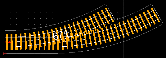

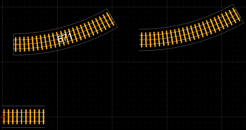

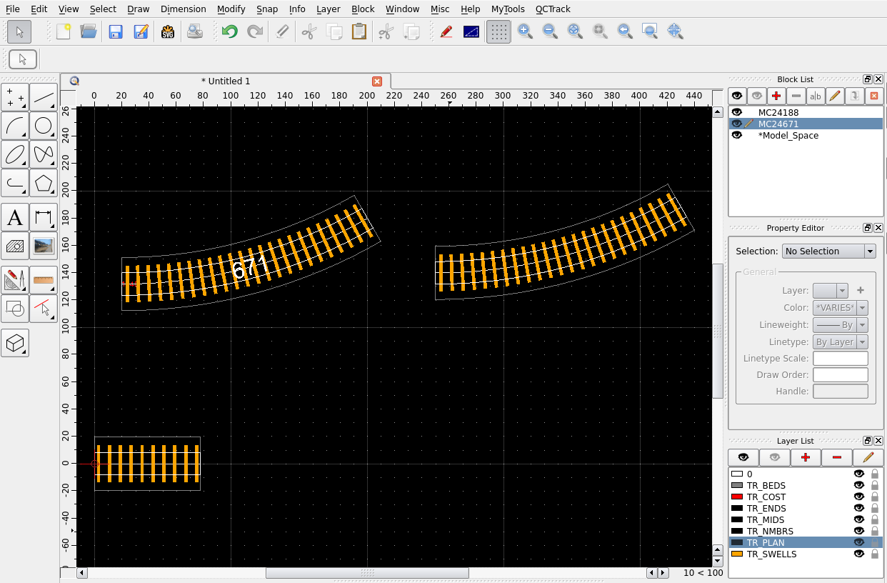

To create more complex elements than just straight or curved elements, you may edit the created blocks as needed. In this example, I will show the required steps to create a curved turn out like Maerklin 24671 which has 360mm radius and 30° curves which have an offset of 77.5mm.
First, create the "base" element just like a "normal" element: At the Model_Space (the normal work space, not inside any block), create a new curved track via QCTrack / Create menu:
Create base element
Then, change the current block space by double clicking the newly created MC24671 block in the QCad Block list. You now should be able to select elements inside the newly created MC24671 element. Select all elements and move them all together some distance away (we will need them later).
Next, again select QCTrack / Create, but this time leave the "block name" empty (maybe you will notice that the top check box is deselected and the cursor starts in "Display name" instead of "block name"). Leave "Display name" empty, again enter 360 / 30° at the bottom of this dialog and hit "Ok". Again move the created element away.
Now for the third time select QCTrack / Create, leave "block name" and "Display name" empty and enter "straight 77.5" to create a straight element.
Your QCad window should now look similar to this:
All parts are created

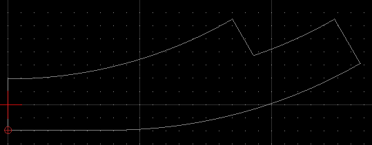

Now select only TR_PLAN to be visible. Remove the short ends of the straight element and the left end of the curved element without display name.
Remove the same lines on TR_ENDS and the something longer lines on TR_BEDS. (Means: you remove three lines on each of those three layers.)
All layers visible now you have:
Edited parts

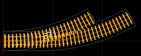

All parts are created now, so let's move them to the appropriate position with the normal QCad command (like "mv" for move with "se" for snapend using the bottom left ends of the bed lines):
Parts moved
Now adjust the lines on the TR_BEDS layer as wanted. For me, the following seems to be appropriate (deleting and trimming lines):
Bed is edited
As last step, mark all layers to be visible and select QCTrack / Ensure order of track layer objects. This should put the swells to the back and bring the display name to the front (and also sort all other elements). You should now have:
Done.
Of course, you may edit the swells to look more like they realy do, but this isn't needed. Very importand is only one thing: there must be three (not four, not five, and, of course: not six) lines on TR_ENDS, because all other QCTrack-scripts use the lines on TR_ENDS to connect track elements. So double check if your block has three lines (e.g. select only TR_ENDS layer to be visble and select all elements, then QCad should display "3 Lines on Layer 'TR_ENDS'").
